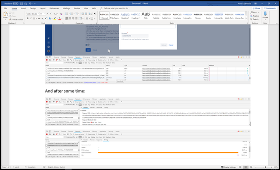

Hi @Andy Heinzer , I have generated HAR file, please go to link https://yadi.sk/d/F3pfhUWGPKyQBA

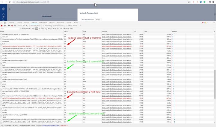

I have also noticed that when I try to upload any screenshot there are some 404 statuses in browser console (requests to https://api.media.atlassian.com/chunk/...), "pending" at first and then 404, I've made a screenshot as well:
404 appears in each case of uploading a screenshot.
Please let me know if you need any other details/information.

I also noticed strange regularity, maybe it might help to figure out the issue:
When I try to upload any new screenshot to Jira comment, every time at first in the console there is a status code 404 "Not found" for the request URL: https://api.media.atlassian.com/chunk/.. And only after that, the status code is 204 and 201 for the same request (please, look at attached screenshot)
It happens all the time for any new screenshot.
(If I try to upload the same screenshot the second time - there is no status code 404 anymore).
It looks like the "Upload" button is inactive in the interval between sending the request to https://api.media.atlassian.com/.. and receiving the first answer (Status code: 404). The interval might be a few seconds or a few minutes.
