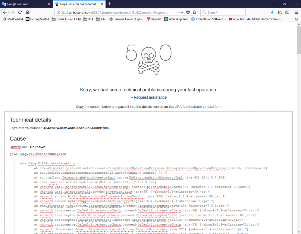

Dears,
please note that the following error problem that i have faced when i tried to delete a bulk of issues:
Sorry, we had some technical problems during your last operation.
Log's referral number: 464e2c74-3cf2-4bfb-9ceb-8d64a6091d86
Cause
Referer URL: Unknown
java.lang.NullPointerException

There is not enough of the underlying error being shown there to begin to diagnose the problem.
You'll need to read the log(<jira home>/logs/atlassian-jira.log) in full to find out what has gone wrong - it should be easy to find the section you need by searching it for the first couple of lines of the detail error in the screenshot.

2017-12-31 13:10:12,551 http-nio-8080-exec-6 ERROR      [c.a.j.web.servlet.InternalServerErrorServlet] {errorId=6d60591a-bd18-44b0-af27-136342861d9c, interpretedMsg=, cause=java.lang.StackOverflowError, stacktrace=java.lang.StackOverflowError

Ohh, that's not going to be nice.
A stack overflow error means Java ran out of memory space.  This is not a case of giving it more memory though, the error is most likely to be caused by recursion - code calling itself inside itself, and increasing memory just means it'll crash a little bit later.
I think this is one that needs to go to Atlassian support, as it's something in the Service Desk application causing the recursion to happen.  I'd ask https://support.atlassian.com/contact
