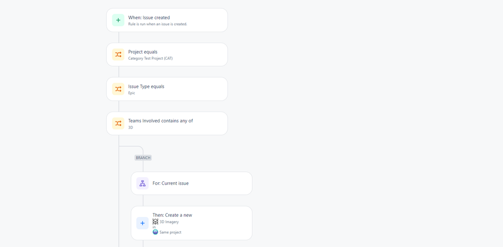

I'm interested in the second option. We have existing issue types and want to leverage a custom field ("Teams Involved") to automatically assign the same value as the issue type. I've attached a screenshot of my attempt for one issue type, but manually repeating this for all types would be inefficient. Is there a way to automate this process using the custom field value to dynamically set the issue type?

Based on the image you provided, this is what I think you are trying to do. Let me know if I have this correct.
When an issue is created
And that issue's type is Epic
Then create a new issue
  • The issue type for the new issue is based on the "Teams Involved" field in the Epic
Is the new issue supposed to be a child of the Epic?
What type of field is the "Teams Involved" field?
Are the values in the "Teams Involved" field exact matches for the issue type names?

Absolutely, that's exactly what we are aiming for! To answer your questions :
  • Yes the new issue type should be a child of the Epic
  • It is a custom field, specifically a select list with predefined options to chose from
  • And yes, it is an exact match for the issue type names

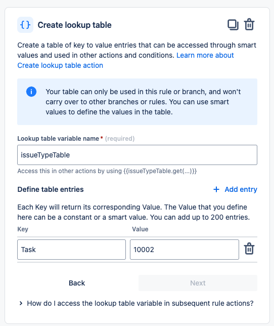

You can use the Create Lookup Table action to create a table that uses your selection list values as Keys, associating them with the unique numeric IDs corresponding to the matching issue types.
Example with just one entry.
"Task" is a value from my selection list. 10002 is the unique numeric ID that is assigned to the Task issue type in my system.
Notice the text directly below the Lookup table variable name field. That shows you have to access the Values in the table. If the name of your selection list is "My Select List", for example, you would get the Value from the above table corresponding to the option in you selection list using a smart value like this:
{{issueTypeTable.get(issue.My Select List)}}
Note that you can use any name for the Lookup table variable name

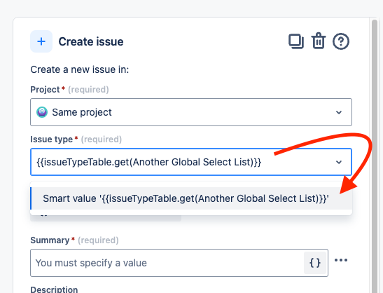

Then in your Create Issue action you would use that value to set the Issue Type field. You have to type that smart value into the field, and then click on the area where what you type was mirrored below the entry field.

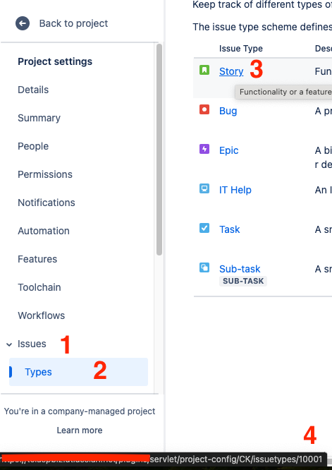

To get the unique numeric ID for the issue types you will have to go to the screen where issue types are listed in the Project settings. In Project Settings click on Issues (1), then Types (2), then hover your mouse over the issue type name (3), and the URL that displays at the bottom of the browser window will include the ID for that issue type (4).
For a Team Managed project the steps are similar, except (1) is "Issue Types" and it takes you straight to the list of issue so step 2 is skipped. Then you simply select the issue type, and in the details for that issue type are displayed. You don't have to hover your mouse over the issue type. And the URL field of the browser window include the ID for the issue type displayed.
