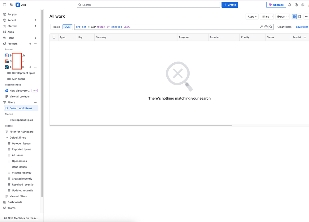

For just one of my project I have some kind of inconsistent state:

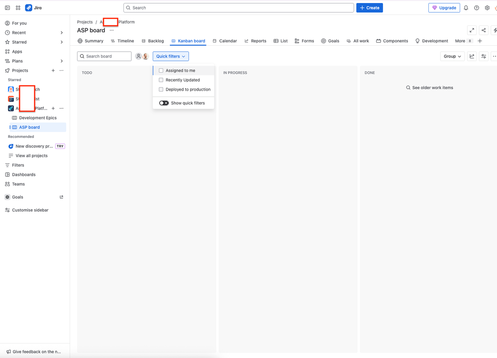

- No tickets are shown anymore on the kanban board of that project
- The issue search (https://....atlassian.net/issues/?jql=project%20%3D%20ASP)  does not find any ticket of that project (but tickets of other projects)

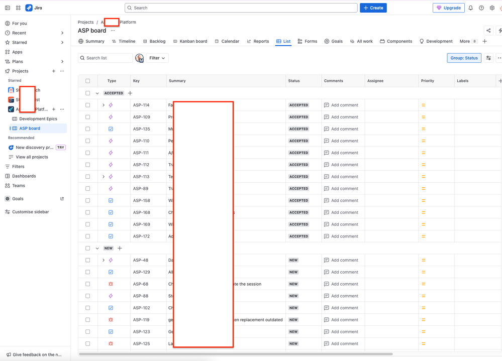

- But I can see the issues in the "List" view of the project and work with them as normal if I open them from that list (or know the URL).

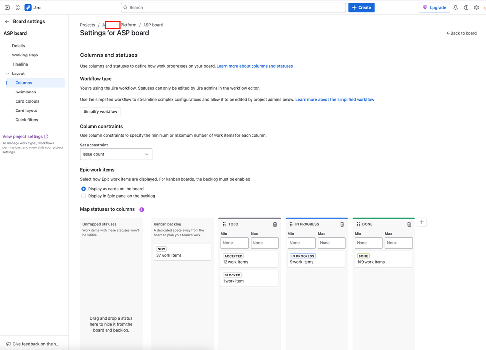

Can you show us the mappings of Statuses to Columns for your board? That would be in the Board Settings.

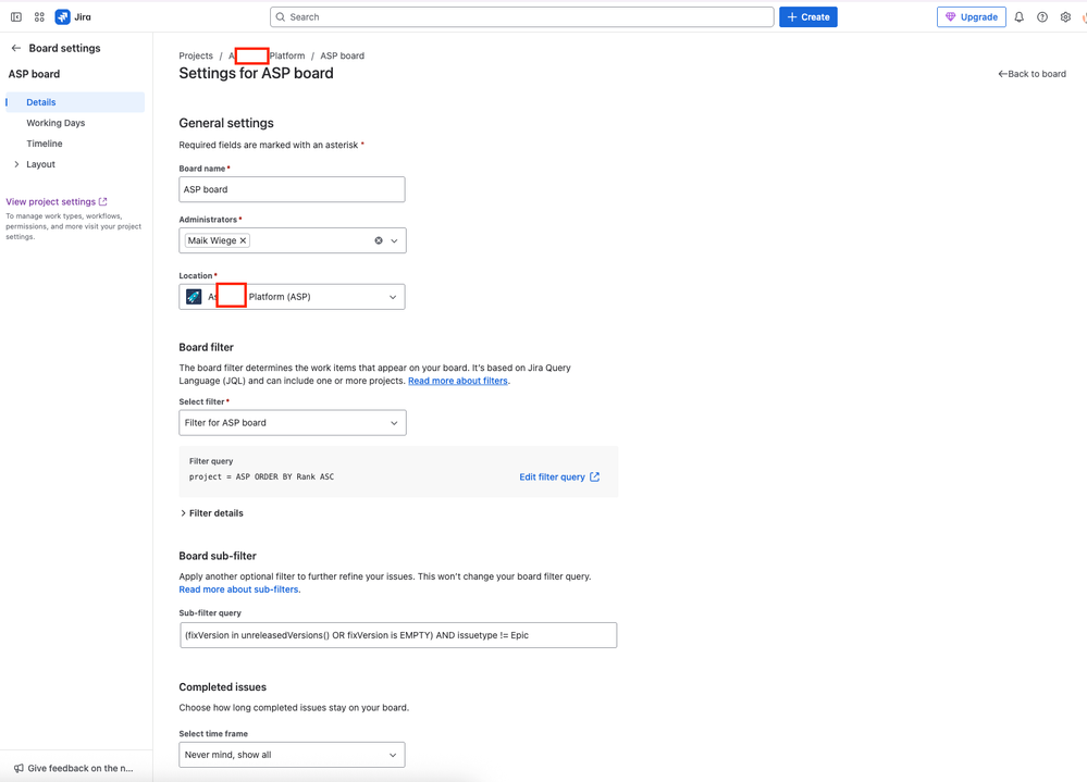

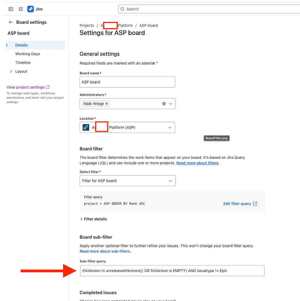

If so, looking at the images you provided previously I see your board has a sub-filter. Can you confirm that there are issues that match this filter?
If you clear that sub-filter, do issues appear in your board again?
I do note that you also said that when this occurred previously the issues were also not found through the Filters > Search Work Items screen, which should not be impacted in any way by the sub-filter on your board.

So the Sub-filter also can't be the reason (besides the mentioned problem that during the time where the tickets are gone they can't even be found in the JQL search), because now the tickets are back and the sub-filter is still in place.

And here are the screenshots of my different screens:
