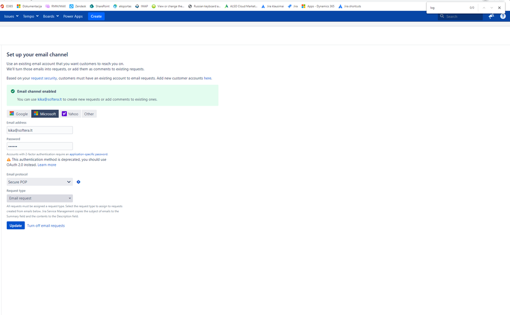

Our client requested that they need Request Type of an issue created via email to be set as Problem, not Email request. As an example below (shown in the picture), I created Request Type manually:

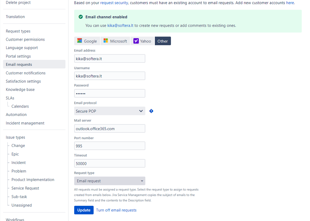

While selecting this type of parameter, the issue for some reason isn't created. In Email request section I chose this Request type I created:
Although, It says Email channel is enabled but we still don't receive issues:
I checked the mail flow settings - it says that the email is delivered.
Could you please guide me through any necessary steps I have missed? Are there any additional steps that I need to proceed with?

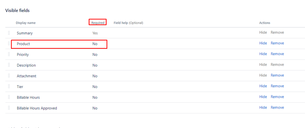

In the problem type, is 'Product' a required field?
For email processing, there shouldnt be a required field.
Jira Softera
June 4, 2021
Where should I check this? In global project settings and problem causing project settings itself I don't see this kind of problem type as a required field.

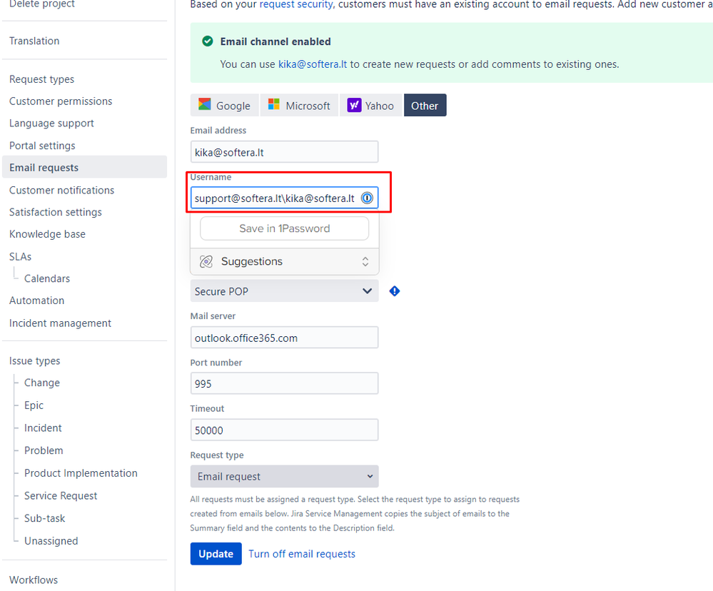

Also, I'm thinking, maybe it's related to Jira updates related to project email settings. What I mean is, that before the version update when we create project and configure email requests in the username field we would write like this:image.png
After the update, when we configure email requests, we also write support@softera.lt at the beginning of the username but when we reload page it displays as this still:

As per the error message, in the current issue type behind the 'Request type' that is mapped for the email requests (report a problem?) has the field Product as required.
If you make the field not mandatory, it might help. Check for it in the field configuration scheme of the project.
Refer to https://confluence.atlassian.com/servicemanagementserver/setting-up-request-types-939926357.html and https://confluence.atlassian.com/adminjiraserver/specifying-field-behavior-938847255.html
Jira Softera
June 4, 2021
As I understand, this was already set as not mandatory.

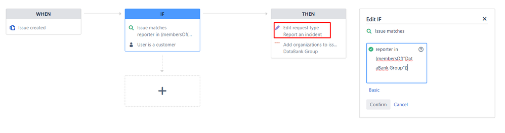

I changed Issue request type to email request and now I'm getting issues via email but i still need my issue request type be as Report an incident. I tried to create custom Automation rule:

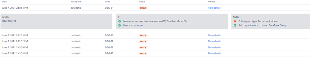

But I'm getting these errors:
Have any ideas on how to resolve the problem?
