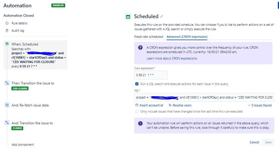

Ah, now that I think about it, I believe it is your query. try doing the Planned end date as < now()
Giuseppe Amoruso
May 21, 2021
Hi, can you give me the correct syntax? Just to make no mistake.
BR,
John Funk
May 21, 2021
Just update exactly what you have already except change out
> startOfDay()
with
< now()
Giuseppe Amoruso
May 16, 2021
