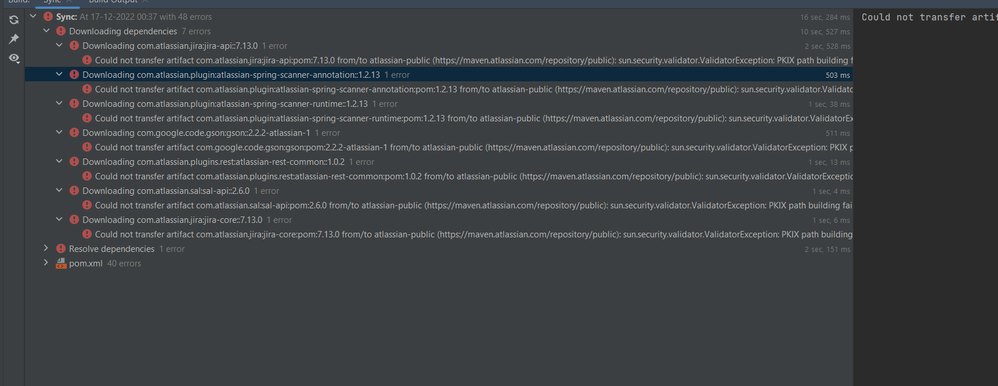

This Issue is happening during importing the  custom Plugin in Intellj IDE on client  system.
These plugin is developed in my   local systemon Intellj.
Version:
Atlassian SDK  : 8.0.16v
intellj  IDE          :2022.3 v
What could be the possible cause. Why it failling import . Is it related to Java certificate or security between jira plugin/ intellj with JDK .
Any help would be appreciable
1. Exception : Could not transfer artifact com.atlassian.jira:jira-api:pom:7.13.0 from/to atlassian-public (https://maven.atlassian.com/repository/public): sun.security.validator.ValidatorException: PKIX path building failed: sun.security.provider.certpath.SunCertPathBuilderException: unable to find valid certification path to requested target
Reference  blog(What i found): https://community.developer.atlassian.com/t/unable-to-build-inhouse-plug-in-because-of-the-error-could-not-transfer-artifact-com-atlassian-jirapom-7-13-2-from-to-atlassian-public-https-maven-atlassian-com-repository-public/28825/8
