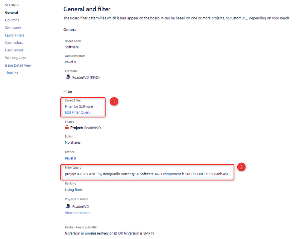

While on the board, click on the 3 dots menu in the upper right.
Select Board Settings
In the General tab you should see the board filter. You should be able to click on that, update it and save it and then return to the board.
The first one or the second one?
I can't update the second one.
And what do I need to enter in the filter to show all the issues, f.e. in the timeline?

try to use the filter project = RIVD ORDER BY Rank ASC
Most likely it is the AND "System[Radio Buttons]" = Software that is causing the issue you are having. If this custom field is not being set on the create issue screen your board filter will not be able to display it and will display the error you are experiencing.
If you click Edit Filter Query in the first red box and remove this and save the filter and try to see if the issues are showing up.
It could potentially be the other part as well AND component is EMPTY if a component is automatically set on the issues created (or set on the create issue screen) you can try this as a second option.

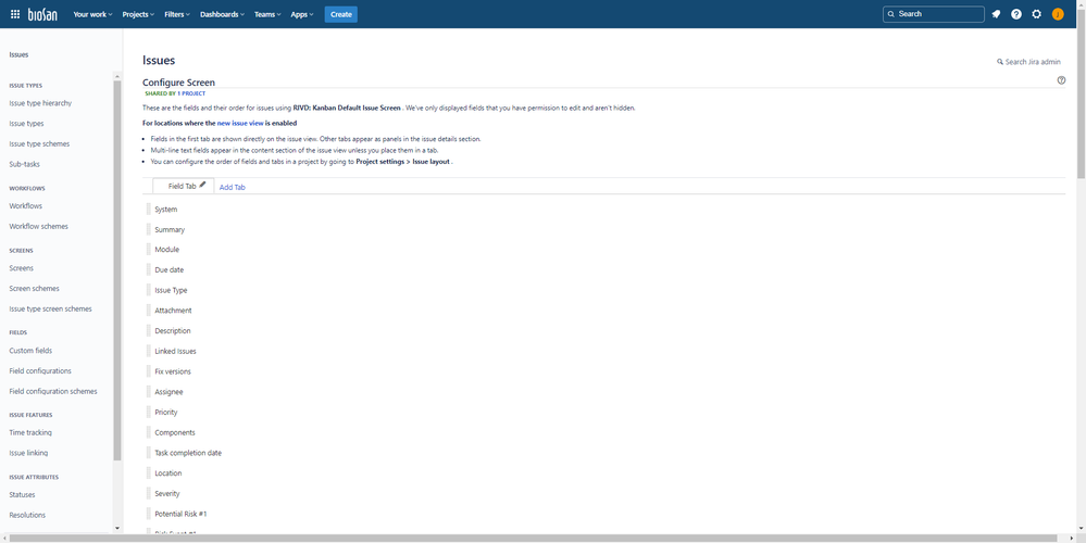

Yes, your option then is to make sure that the custom field System is present on the create issue screen - and also set (click the correct radio button) to Software
If System custom field is not set to Software on the create issue screen your issues will not show on the board.
If you can post a screenshot of your create issue screen

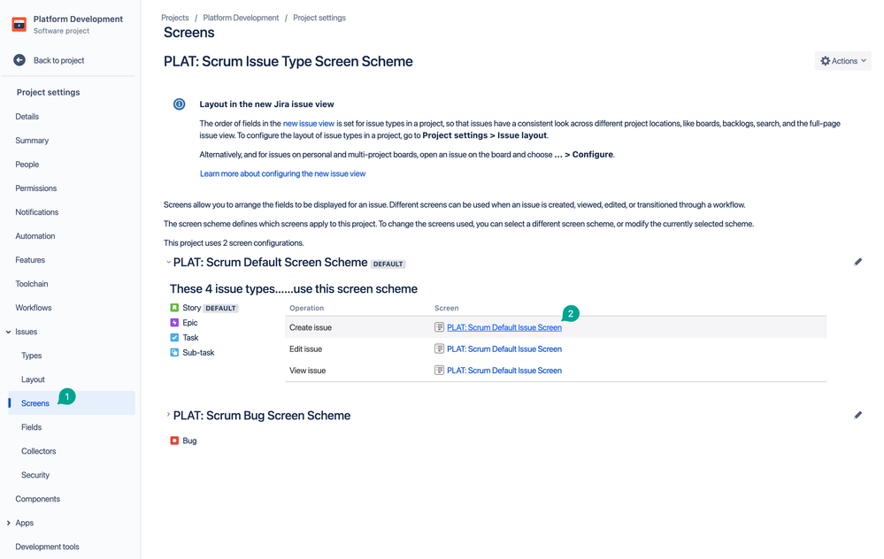

Go to your project and click Project settings at the bottom in the left hand menu.
Then follow these steps: "1" click Issues/Screens and klick on "2" the create issue screen and take a screenshot of that
