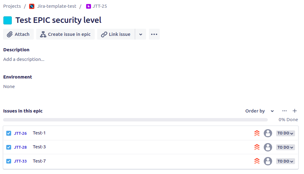

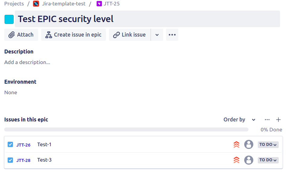

screenshot of an EPIC before associating the "Issue Security scheme",

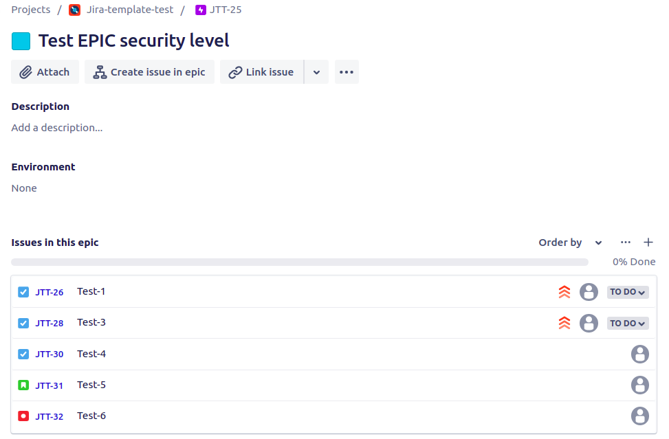

  screenshot of an EPIC after associating the "Issue Security scheme" and when tried to create an issue within the EPIC,

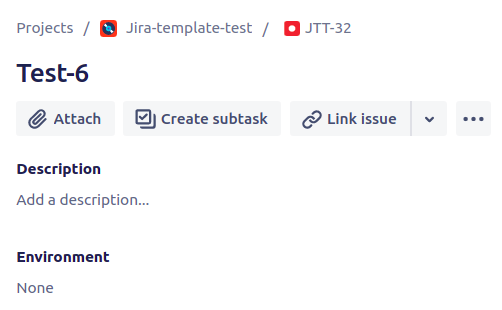

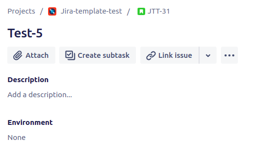

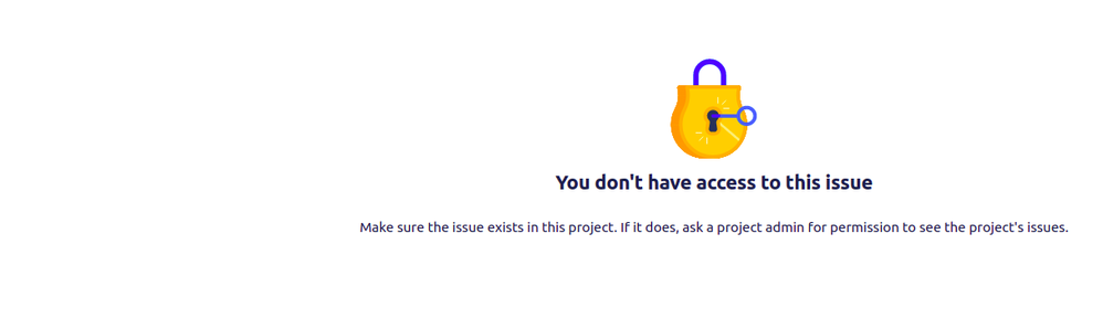

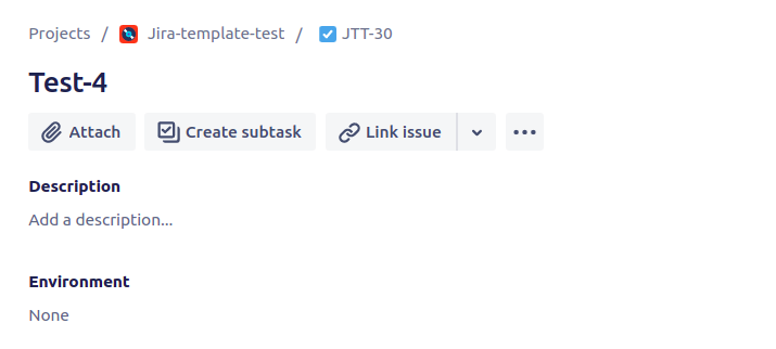

As you can see issues Test-4 (JTT-30), Test-5 (JTT-31) and Test-6 (JTT-32) issues are visible but not accessible. When tried to access below is the screenshot of the result,

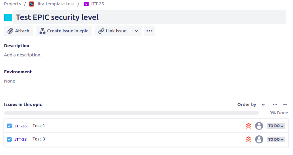

When "Issue Security Scheme" is disassociated from the project then Test-4 (JTT-30), Test-5 (JTT-31) and Test-6 (JTT-32) issues are visible but not linked to the EPIC (JTT-25). Below are the screenshots of the result,
