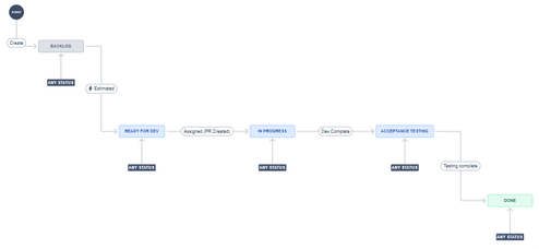

Here's workflow that I have setup for my Next-Gen project:

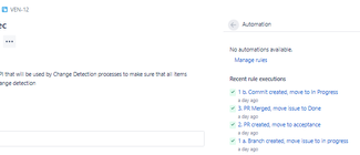

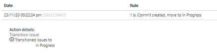

In my card, I'm able to see that the automations are getting triggered:
Also, the Automation also shows "success" in the history log:

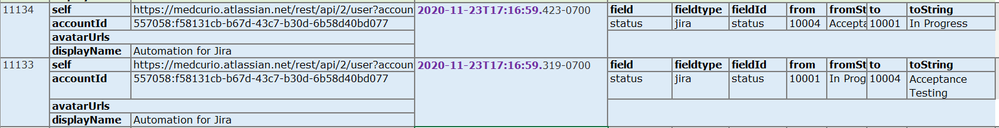

Here's information that I'm seeing in the "changelog" portion of JSON when I call .../rest/api/2/issue/{{issue-key}}?expand=changelog
JSON details:

"created": "2020-11-23T17:16:59.423-0700",
"items": [
"field": "status",
"fieldtype": "jira",
"fieldId": "status",
"from": "10004",
"fromString": "Acceptance Testing",
"to": "10001",
"toString": "In Progress"
"historyMetadata": {}
"id": "11133",
"author": {
"self": "https://medcurio.atlassian.net/rest/api/2/user?accountId=557058%3Af58131cb-b67d-43c7-b30d-6b58d40bd077",
"accountId": "557058:f58131cb-b67d-43c7-b30d-6b58d40bd077",
"avatarUrls": {
"48x48": "https://secure.gravatar.com/avatar/600529a9c8bfef89daa848e6db28ed2d?d=https%3A%2F%2Favatar-management--avatars.us-west-2.prod.public.atl-paas.net%2Finitials%2FAJ-0.png",
"24x24": "https://secure.gravatar.com/avatar/600529a9c8bfef89daa848e6db28ed2d?d=https%3A%2F%2Favatar-management--avatars.us-west-2.prod.public.atl-paas.net%2Finitials%2FAJ-0.png",
"16x16": "https://secure.gravatar.com/avatar/600529a9c8bfef89daa848e6db28ed2d?d=https%3A%2F%2Favatar-management--avatars.us-west-2.prod.public.atl-paas.net%2Finitials%2FAJ-0.png",
"32x32": "https://secure.gravatar.com/avatar/600529a9c8bfef89daa848e6db28ed2d?d=https%3A%2F%2Favatar-management--avatars.us-west-2.prod.public.atl-paas.net%2Finitials%2FAJ-0.png"
"displayName": "Automation for Jira",
"active": true,
"timeZone": "America/Denver",
"accountType": "app"
"created": "2020-11-23T17:16:59.319-0700",
"items": [
"field": "status",
"from": "10001",
"fromString": "In Progress",
"to": "10004",
"toString": "Acceptance Testing"

From my understanding, you have two active transition automation rules.
One which fires on a pull request merge.
The other which fires on a commit created.
And as you have noticed, when a PR is merged both rules are executed causing the unwanted double transition behaviour.

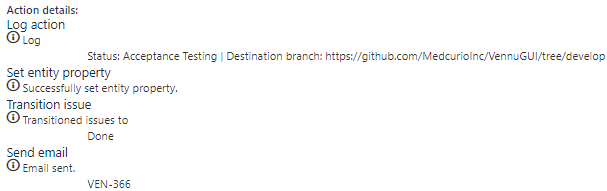

Here's information from audit trail:

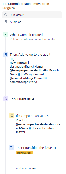

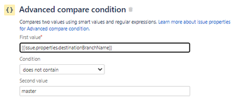

Then, in the "commit rule" I have the following:

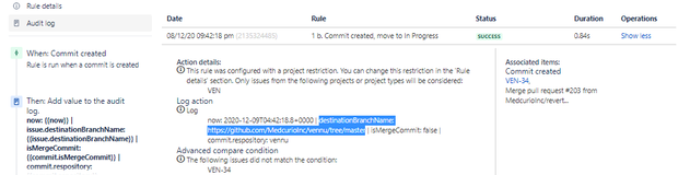

I can see in the audit log that {{issue.properties.destinationBranchName}} is returning the full URL of the destination branch.
This includes "master" so it seems as though the "Does not contain" comparison operator simply isn't working ...

In audit log entry 2439243212, I see the following:
In the rule, the text that immediately follows "destinationBranchName:" is {{issue.properties.destinationBranchName}}.
It appears that even though {{issue.properties.destinationBranchName}} works when setup in the context of sending smart values in an e-mail, it is not working to grab the custom property when the commit rule is being evaluated.
It seems like there are one of two issues:
A. There's a race condition. e.g. The evaluation of the "commit" rule is checking for {{issue.properties.destinationBranchName}} before the "merge" rule has saved it off. The e-mail content works b/c steps evaluate sequentially with the rule.
B. The smart value syntax works differently when used in sending e-mail contents vs. evaluating rules.
Thoughts or ideas? e.g. is there some way to introduce a 1 second paus within a rule evaluation to confirm theory A?

Here's the full rule for the commit trigger:

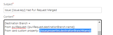

Here's what I have in the e-mail for the "PR Merged" rule:
{{issue.properties.destinationBranchName}} works just fine in this context.
