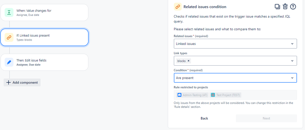

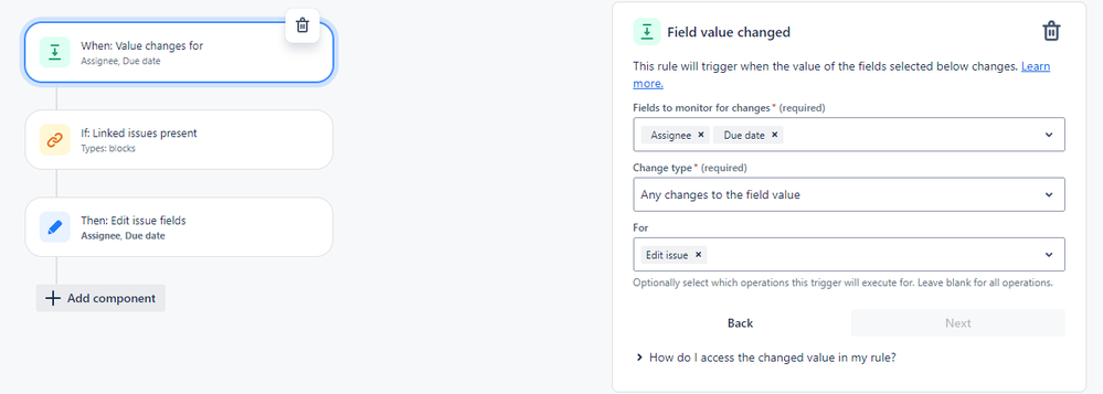

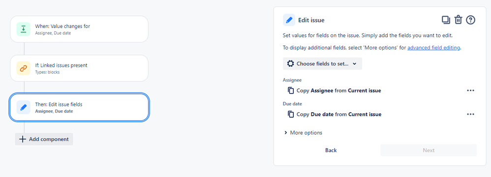

I have tried the rule as you can see in the screenshots. Including changing the Edit issue action from current issue to trigger issue, and the condition from linked issues present directly to issue fields condition Link is not empty.
Additionally tried the FOR to be set as all issue operations, edit, create, and nothing seems to trigger although I see in the audit logs sometimes that the rule runned successfully or that runned with no actions taken.

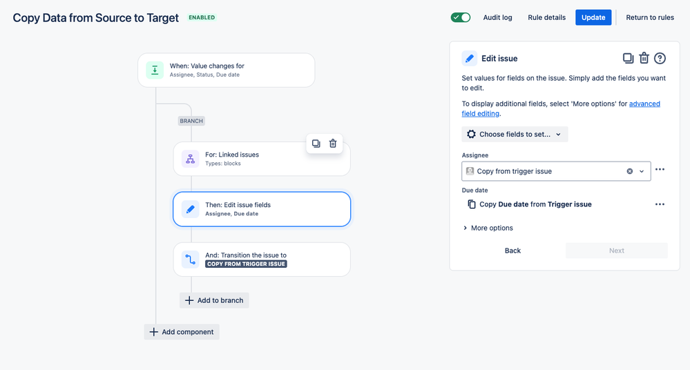

If I've got that right, then your automation rules are close! You're missing the "For: Linked Issues" action branch. Here's a screenshot of what your automation should look like.
A couple things to note:
  • You'll want to use the "For: Linked Issues" condition block
  • I would recommend adding in conditions before the "For" block to restrict this to the project that triggers these changes
  • Both projects should be "Company Managed" and sharing the same Statuses. It's important they share the same back-end Status IDs. The best way to accomplish this is to ensure both projects are using the exact same Workflow, or ideally Workflow Scheme.
    • If the statuses are different between the projects, the transitions may pose a challenge.
    • In the workflow, you will want to make sure any status can transition to any other status. If the transition cannot resolve, then the automation rule will not properly execute.
  • You may want to consider locking down the permissions on the destination projects, so that only the Automation for Jira app can make changes, and your trigger project ends up being the "source of truth"
  • When selecting the values to copy, you want to select "Trigger Issue", as this will copy the data from the issue that started the automation, in your case, from the triggering project.

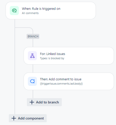

If you don't mind, just to end, can you also help me check my comments copy rule? I have tried triggers as all comments or new comment added. Yet it is not working.

Your automation structure should work here. Your "For Linked Issues" may have the type set incorrectly to "issues blocked by" instead of "blocked", so I would double check that. I did test the same structure that you have provided (with the added change of updating the Link Type to Blocked), and the functionality is working on my Cloud site.
The automation section also has an Audit Log, which help to provide some clarity on why errors may be occurring. I would give that area a check as well.

Thanks; I set the branch for: as blocked by because I thought it would make the changes against those tickets.
Anyway, trying both ways (blocked by, and blocks), also trying adding the Jira Automation actor to the projects' permission scheme is not solving the issue.
When I go to the audit logs it always says "No actions performed" and "Branch rule / related issues - No related issues could be found."
Thanks once again.
Christian Isaza September 26, 2024
Hey @Robert DaSilva I just found my issue :D and was able to solve it.
The issue with the comments copy was that I just had in the scope the wrong projects (bad idea to have too many projects with similar names) :D
