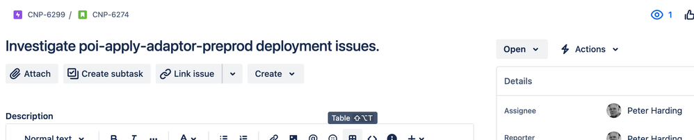

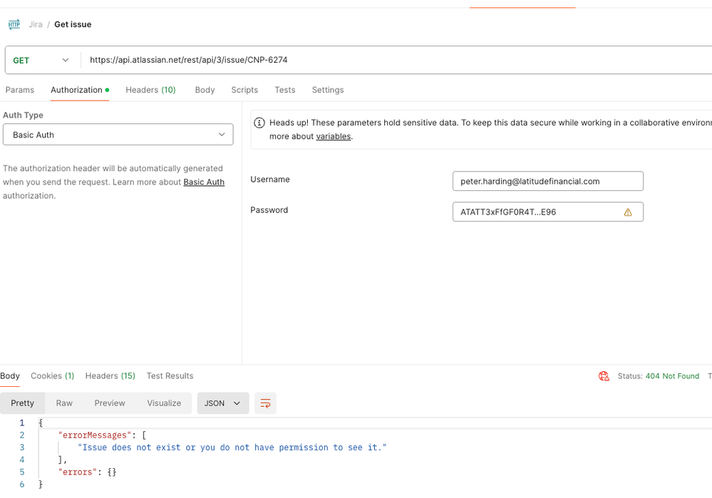

I am requesting - https://api.atlassian.net/rest/api/3/issue/CNP-6274 (GET) - in Postman with:
I am logged into Jira using SSO - the above email - and I have created an API token in my account - I still get a 404 NOT FOUND - and I can see it in the web interface:
What am I missing?

Hello @Peter Harding
Is the base URL you are using in Postman a match for the base URL of your Jira cloud instance? In postman you have https://api.atlassian.net . Is that the same base URL you see when you are looking at the issue through the Jira UI?

I have also tried
* jira.atlassian.net; and
* latitudefs.atlassian.net (which is the baseUrl used in our browser based Jira)
With jira.atlassian.net I get:
"errorMessage": "Site temporarily unavailable",
"errorCode": "OTHER"
With latitudefs.atlassian.com I get:
"errorMessages": [
"Issue does not exist or you do not have permission to see it."
"errors": {}
