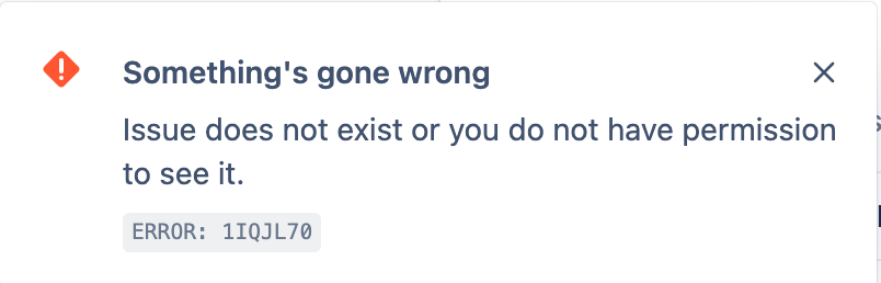

Hi, all of the users (admin and team members) in the workspace experience this issue.
When we want to create issue in backlog, it gave me the alert. The error code changes but the issue still persist for several days.
we already have this project since January 2022 (5 months), but the issue just occur this week and we don't change any permission.
A help will be great!

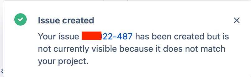

Thanks for your response. few hours ago I tried to create task from Roadmap > Epic > "+" sign for Create Child Issue > create task. It created the issue, but I am unable to open it

However, I just tested this again before I reply to you and I got a generic error when trying to create a task from an ongoing sprint.

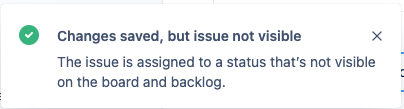

for Backlog, It says it is successful but I can't see the task. Attached is the alert

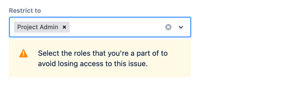

found the root cause, in the project level ~ the Task & Story by default are set to Administrator ~ whereas myself is part of Member. That's why I have no permission.
Once we removed the rule for Restrict to, we are able to create issue again. Thank you @DasJo Screen Shot 2022-05-24 at 16.22.40.png
