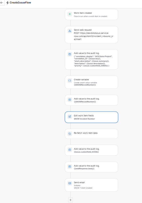

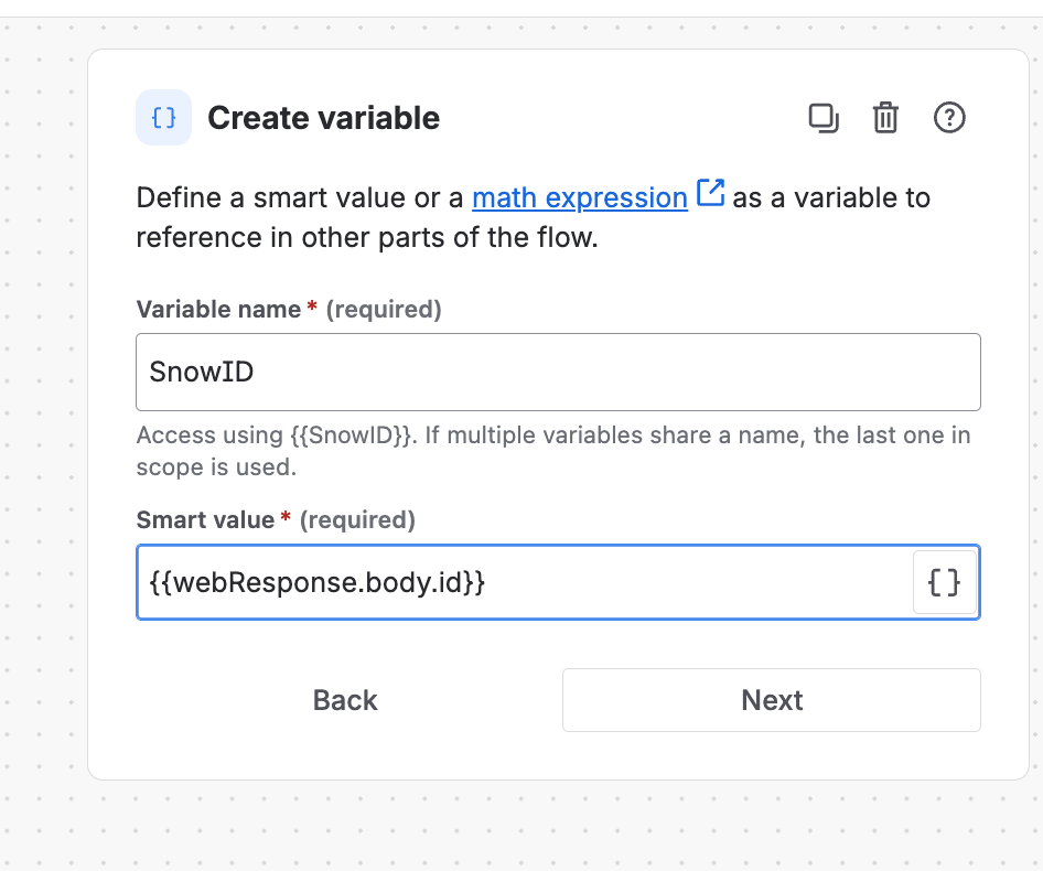

Hi,
I have one automation that creates a ticket in SNOW. I get the result SNOW Number field. I tried to save this in the custom field so that I can use this same variable value for the update automation flow. ( as SNOW will need this to update the issue) But it is not working. Can you help with the exact action that will help me save this variable value to the particular issue ( it cannot be a global variable as it will change for different issue creation requests)

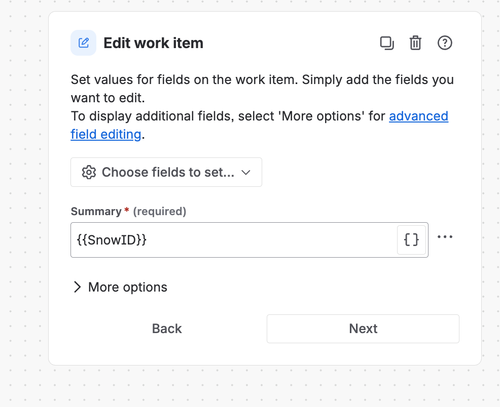

Hi @vishalkalra
So your jira automation makes a rest call to snow and in response it gets the snow id and want to find the best way to store it in a jira field? like this

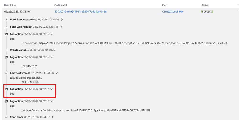

vishalkalra
May 24, 2026
Hi @Fazila Ashraf , @Trudy Claspill
Thanks for your response. I tried the same but when I try to log the SNOW number value that I have saved in the custom field, it does not print it.

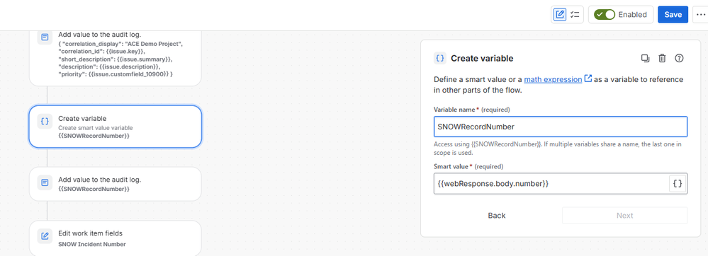

vishalkalra
May 24, 2026

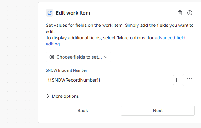

Hi @Trudy Claspill createFlow.pngcreateVariable.png,
PFA the screenshot for the entire flow.
When I see the logs, I see the value for the {{SNOWRecordNumber}} is getting logged correctly, but after assigning this same value via Edit Work item action to the custom field and then logging the custom field, it does not show it.createflow_entire audit.png
Trudy Claspill
May 24, 2026
After editing the work item you need to execute a Re-fetch Data action to get the current data for the work item. Otherwise your log action may be printing cached data from the work item obtained before it was edited.
Please also show us the details where you are setting the custom field within the Edit action and the details of the step following that where you are trying to write the data from that custom field into the log.
Lastly the images of your flow still are not showing the entire flow since the last visible action is the Edit but you have said you are logging data after that.

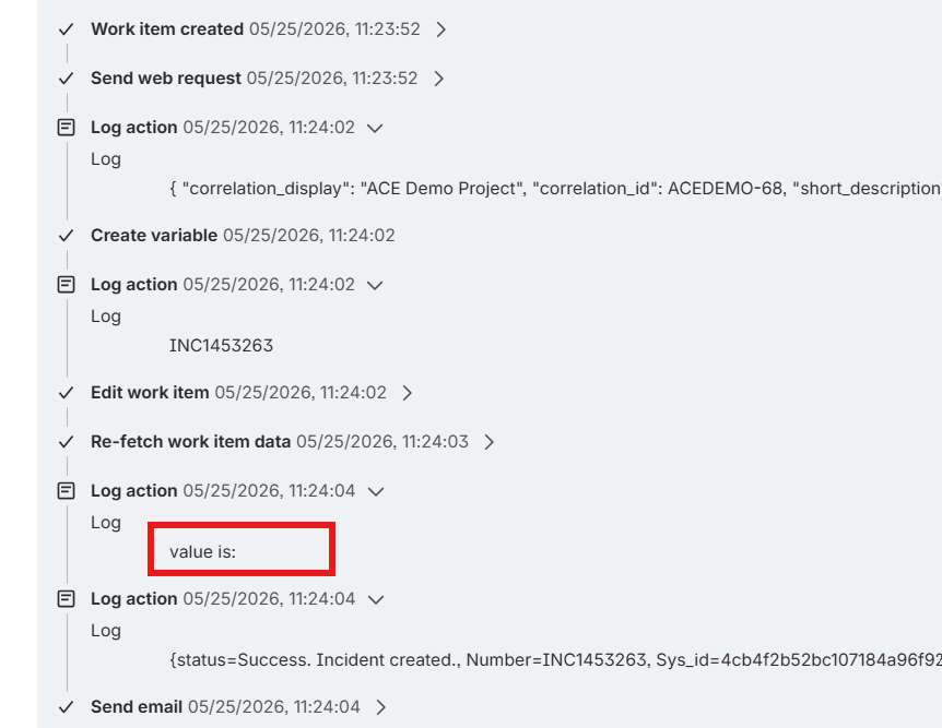

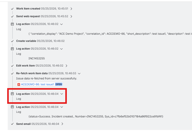

vishalkalra
May 24, 2026
Hi @Trudy Claspill ,
PSB the required screenshots, Note: Finally I want to use the value in the second automation but for now I am trying to log and check in the current automation to confirm if it is getting logged or not. auditlogs_refetch.pngcreateIssueEntireFlow.pngeditWorkItem.png

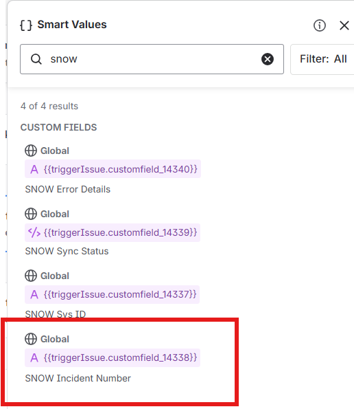

In the Log action after the Re-fetch action you are logging a field based on its custom field ID. How did you confirm that is the correct ID for the SNOW Incident Number custom field?
In each Log action I also advise adding some text so that you can correlate what you see in the log to specific Log Actions. Anything not in curly brackets (not a smart value) will print as plain text during a Log action.
vishalkalra
May 24, 2026
Hi Trudy,
I tried this as well ( adding text) and I see blank value.
For the id, that is the value that is appearing in the smart values lookup. PFA snow_incident_number_Field.pngvalue_logged_blank.png
