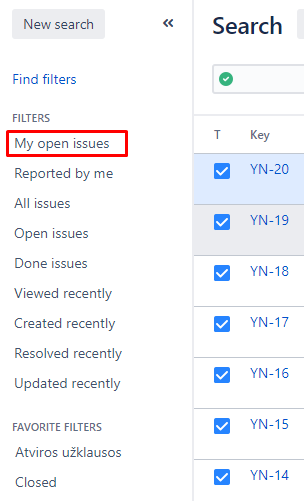

When a worker looks for issues, he can choose filters:image.png
If he uses My open issues filter, he also sees issues, which are associated but not assigned.
Nic Brough -Adaptavist-
May 18, 2021
My open issues reports "assignee = currentUser() and resolution is empty", it does not look at team.

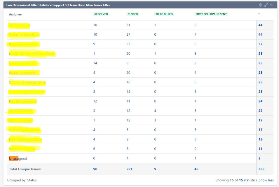

User also mentioned, that he can see unassigned issues here:image.png
What I need to find out is it possible after associating issue to a team,  to make it visible only for people, who are members of a team?
