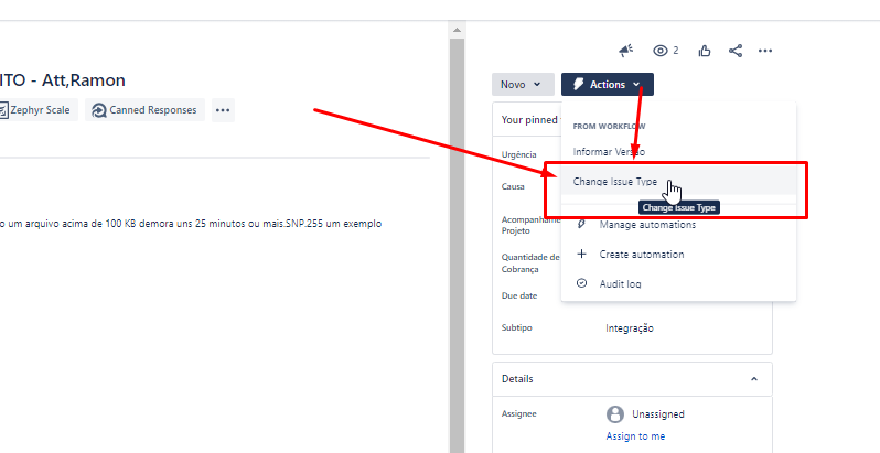

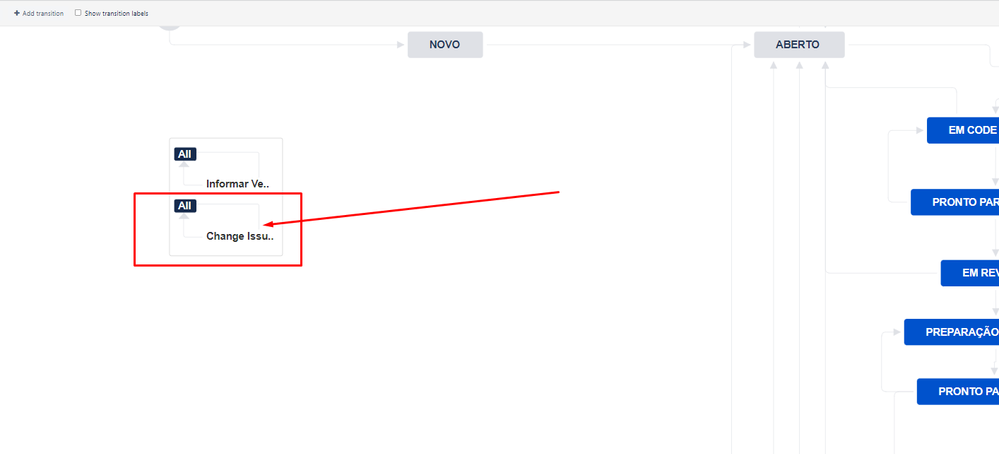

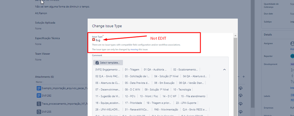

I created a loop transition in the workflow and a screen to change the type of problem, but it didn’t work. The transition opens the screen and the problem type field does not enable the field for editing.
1 - Transition in workflow:
2 - Run transition in issue:Change Issue Type II.png
3 - The Issue Type field does not enable editing:
What should I do to enable this field...?
Mark Segall
May 22, 2023
Apologies for not clarifying in my previous message, but the loopback transition only works if issue types share the same workflow.  According to the message in your last screenshot, the Bug issue type has an isolated workflow.  In this case, you would need to perform a bulk edit (move) action.  This requires granting select users the global bulk edit permission.
