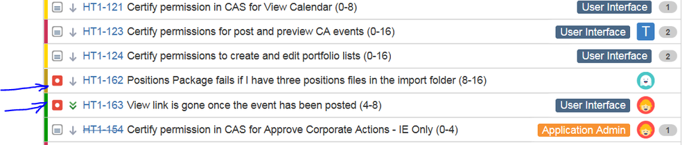

Could you give us a screen shot of the backlog showing stories with the estimate and missing from bugs?

Hi Nic, above mentioned snapshot shows the Sprint backlog, where the stories have the story points but the bug created does not show with story points on the sprint backlog.

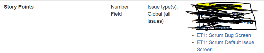

  • Nip into Admin -> Custom fields, and find the Story Points field - can you confirm that you only have one

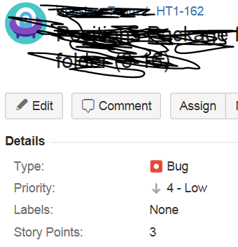

  • Go to HT1-162 and HT-163, and check they have Story Point values set

Right, that's the problem - your bugs are using the wrong story point field.
You need all the issues to use the same Story Points field.

Nic, need further clarification here.
The first screen shot is duplication. All the issue types(Story, Bug etc..) are using the Story point field. We are using the ET1: Scrum Bug screen for Bugs and ET1: Scrum default Issue Screen for all issues.
Are you suggesting that we should be only using ET1: Scrum default Issue Screen for all issues for all issues including Bug.
Please clarify.

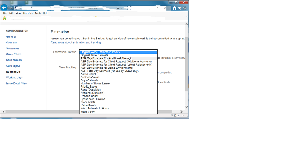

Another test I need to do I'm afraid.  Could you go to the board configuration and look at the estimation tab.  I'd like to see what the list of options looks like on the drop-down (don't change it, just need to see a screenshot of the list after you click to get the list)

Ah, not what I was expecting, but it answers it.
Your board is set to look at Original Story Estimate.  That's the column that appears on the right hand side adding up points.
You need to put your estimates into that field instead of Story Points.
