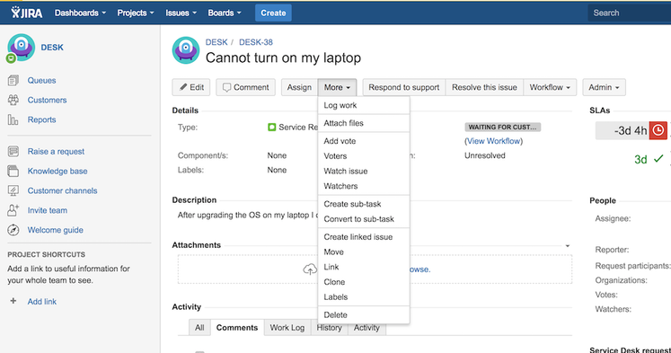

I am not sure I understand what you are seeing here.  When looking at the issue details page, by clicking the More menu, you typically should only have options like so:
But it sounds like you might have different options here.  If so, I am not sure I understand exactly how that customization might have been accomplished for Jira.   This certainly isn't something you can configure within the UI directly for Jira.
