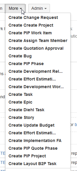

Hello all,
I'm quite new to JIRA administration and I have a problem I couldn't solve by googeling.
My company has two JIRA instances (test and productive).
The test instance is working fine, when pressing the 'More' button in the issue view only the 'standard' options like 'Log work','Rank to top','Attach files', etc. appear.
But in productive system the 'More' button contains a lot more options (see screenshot below). The system allows the user to create new issue with any issue type available in the system. And I don't know how to prevent the system from displaying these options.
Hopefully anyone of you can help me. Thank you in advance.

This looks like an add-on has inserted options into the "more" menu, which is a bad idea in my opinion.
What add-ons are there in your production system?  An admin could do this with Script Runner as well as dedicated add-ons for it.

We use serveral add-ons in productiv system. Script Runner is one of them. Also we have written a company specific plugin.
So I will check the plugins and hopefully come back with the source of the problem and a solution as well.
Marc Fuchs October 23, 2017
I found the 'evil' plugin. :D
The WBS Gantt-Chart Plugin was causing the problem. Now we have to find an other plugin with the same functionality as WBS Gantt-Chart....

WBS Gantt chart has the configuration to remove the create child issue button in the JIRA issue browsing screen.( 'More' button in menu bar)
Cogwheel icon > Add-ons > 'Child issue creation'> Edit > 'menu Location in JIRA'> Uncheck the 'Top in Operation bar' and 'Bottom operation bar.' If you also don't need in issue panel, please uncheck ’WBS Gantt panel 'as well.
