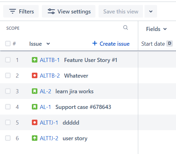

Hi,
a newbie here.
I see several troubles with Jira Issue ID and would like to understand how this is ok for everyone.
1.  There is no way to tell the issue type by looking at the issue ID. The only indication is the tiny icon that can mean one thing in one project and another thing in a different project. There is no text representation of it. It is against all the basics of the usability and I wonder if this can be changed.
2. Issue ID contains the project identifying prefix. So when we move issues from one project to the next, or rename a project, the issue itself has its ID changed.
This is a problem when we need to track items and refer to them externally.
I guess there is some internal ID for every issue and wonder if the Issue ID can be replaced by a custom field that would be a combination of the <issue type> + <running number within the issue type>?
Thank you

Different organizations work in different ways and slapping a newcomer right away by telling them their work process is all wrong just because a tool does not support it is a bit strange.
Not everyone here has a 20:20 eyesight, some people are color blind and so using the tiny icon to convey a critical information is a big no in UI design. In fact it does not stand the UI standards.

I see these everywhere. the Plan and My Work list are the worse because it does reveal the type even upon mouse over event, but they are also displayed in other locations.
We move work items from team to team all the time, especially when we need to consult one another, check things etc. Tracking items that keep changing their ID is a nightmare.
