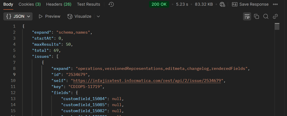

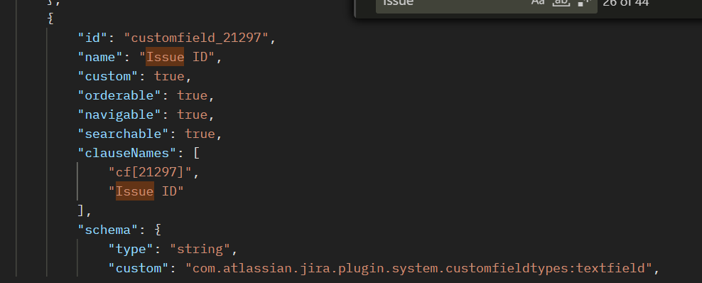

Issue ID and id are they both same or different ?
Sai manoj kumar_ Kolisetty
February 28, 2025
The Issue ID in the 1st screen shot is same as the id field that we got as a part of response response to get issues API call in 2nd screenshot

The id field is the number that represents the issue in the database, what you want to do is use the key instead, like:
key != ABC-1234
And that should work. As a side note, you can view the ID of the issue by doing:
/rest/api/2/issue/ABC-1234
And in the JSON Repsonse, you'll see:
    "id": "81250",
    "key": "ABC-1234",
So if you really wanted to, you could then do:
id != 81250

Hi @Sai manoj kumar_ Kolisetty
Welcome to the community,As per your screenshot  Issue id is description/summary right  so need to use ID of that field
 In the 2nd Screen shot ID is project id
Hope this help

i think you misinterpreted it , actually the above screen shot is not an issue list , it's fields API (field metadata) fetched using <JIRA_END_POINT>/rest/api/2/field
and the second screenshot is list of issues fetched via (GET /rest/api/2/issue/{issueIdOrKey}) and id here is specific to issue
So now what my question is:
Is the issue ID I got in the fields list is same as id that has come with issue's API repsonse ?
