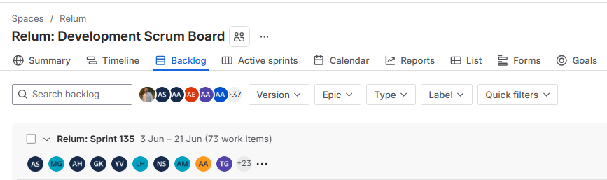

I have the following issue in my Jira Cloud.
I have a company-managed project and a Scrum board.
This is the Query for the Board Filter
project = REL and issuetype not in (Design) ORDER BY Rank ASC
And when searching this JQL, it returns 78 tickets.
Sprint = 444 AND issuetype not in subTaskIssueTypes() and issuetype != Design
But in the Backlog view, the sprint 444 is showing just 38 tickets.
Could anyone suggest a solution?
There is no filter set in the backlog view.

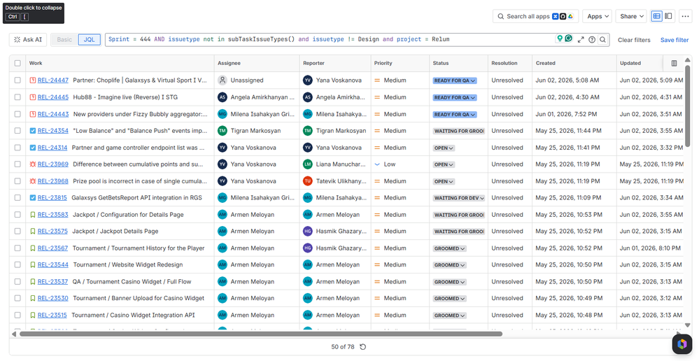

Dears,
Sorry, the 48 should be 78.
Via this query, I have 78 tickets.
See the screens.
Also that sprint is future sprint, can it be the issue?

The backlog only counts issues that match the board's filter and sit in that sprint. Your search query has no project = REL clause, so it's pulling sprint 444 issues that the REL backlog deliberately leaves out. Those 10 aren't missing, they just fall outside the board filter. Put the board filter and the sprint clause in one query and the counts should line up:
project = REL AND issuetype not in (Design) AND issuetype not in subTaskIssueTypes() AND Sprint = 444
If that lands on 38, the dropped scope was the whole story. If it's still above 38, the leftover issues have 444 sitting in their Sprint field next to another sprint, since that field is multi value and keeps past sprints once they've been completed. Add the Sprint column to the results and check each row: anything whose current sprint isn't 444 is one of those carry overs, not a true member of 444.

Run the exact JQL query with your board filter included:
project = REL AND Sprint = 444 AND issuetype not in subTaskIssueTypes() AND issuetype != Design ORDER BY Rank ASC
Next, add Project, Sprint, and Status as columns in your search results view.
If the count drops from 48 to 38, the discrepancy is caused by issues falling outside the board's specific filter criteria. If it still shows 48, check the Sprint column closely; some issues might hold Sprint 444 as a historical value while currently belonging to a different active sprint, which explains why they match the JQL but are missing from that specific board's backlog.
Play a little with that, you should find fast what causing it.

Gor Greyan
June 2, 2026
Dear @Artem Nek_Votazz
Thanks. Here's what I've confirmed so far:
  • With the board filter containing ORDER BY Rank ASC, Sprint 135(444) shows 38 issues in the backlog view, and the affected issue (for example REL-24314) is not visible in the backlog.
  • If I remove ORDER BY Rank ASC From the board filter, the backlog count increases to 74 issues and REL-24314 becomes visible.
  • The issue is still returned by JQL searches in all cases, for example:
Returns 78 issues, including REL-24314.
I also removed it from the sprint, from the backlog section, and dragged and dropped it to the sprint, but the behavior did not change. And it disappears from the Backlog view.
Based on that, it looks like the issue exists and matches the filter, but is being excluded only from the ranked backlog view.
