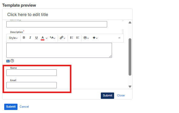

Hi @codemaestro
If user enters value in Name and Email the default field of the Issue Collector Template as shown in below screenshot, then Issue Collector appends the entered value to the end of the Description field. That is the reason why by leaving Description empty, and entering a value in either Name or Email submits the form without error.

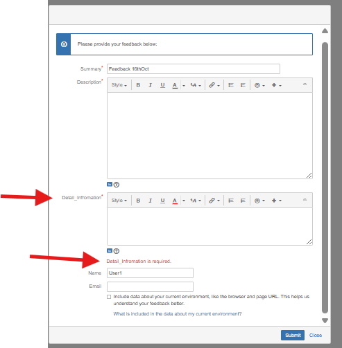

Hi @codemaestro
I would suggest to create a new custom field/s to collect specific peace of information/s from client and make it required from field configuration.
Once the field is set up, add it to the Issue Collector form. This ensures that the client cannot submit the form without providing the required information.
For reference, please see the screenshot below. I’ve added a custom field named "Detail_Information" and marked it as required. During testing, I left this field blank while filling in the "Name" field, and the form could not be submitted—confirming that the required field validation works as expected.
