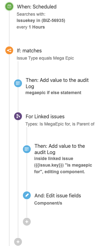

Thanks for the quick reply.  I think I can manage with the first one.  How I go about accessing the field though?  What is the syntax behind it?  Here is how I am accessing it, they are all producing NULL
{{component/s.fieldChange.toString}}
{{components.fieldChange.toString}}
{{component.fieldChange.toString}}
{{fieldChange.toString}}
and my node value is "components":
I can only use smart values in JIRA.  The json edited is locked by the admin

What I tried earlier was what you described.  I had a logger action that had this, below.
"inside linked issue ({{issue.key}}) "is megaepic for", editing component. field: {{component/s.fieldChange.toString}} {{components.fieldChange.toString}} {{component.fieldChange.toString}} {{fieldChange.toString}}"
I then changed the component in the epic and I manually triggered the automation.  This was the log output:
"inside linked issue (BIZ-56729) "is megaepic for", editing component. field:"

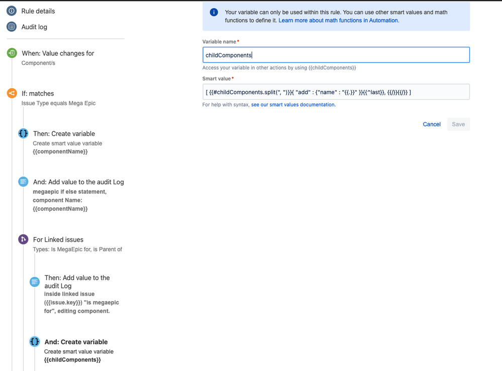

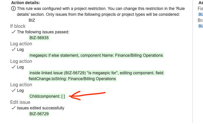

Awesome, thank you @Kalyan Sattaluri !  I got it working now :). What was missing was the trigger.  You were right, I needed to listen to when a component value was changed.  Only then did it work!  I'm going to see what I can do about the second part of your comment since I don't want it to overwrite all existing components!
Where would I added the second condition?  After the branch?  I got an empty output I had when I tried your code
Screenshot 2024-01-23 at 8.51.37 PM.pngScreenshot 2024-01-23 at 8.51.59 PM.png
Kalyan Sattaluri
January 24, 2024
Your last variable, Childcomponent should be:
[ {{#componentName.split(", ")}}{ "add" : {"name" : "{{.}}" }}{{^last}}, {{/}}{{/}} ]

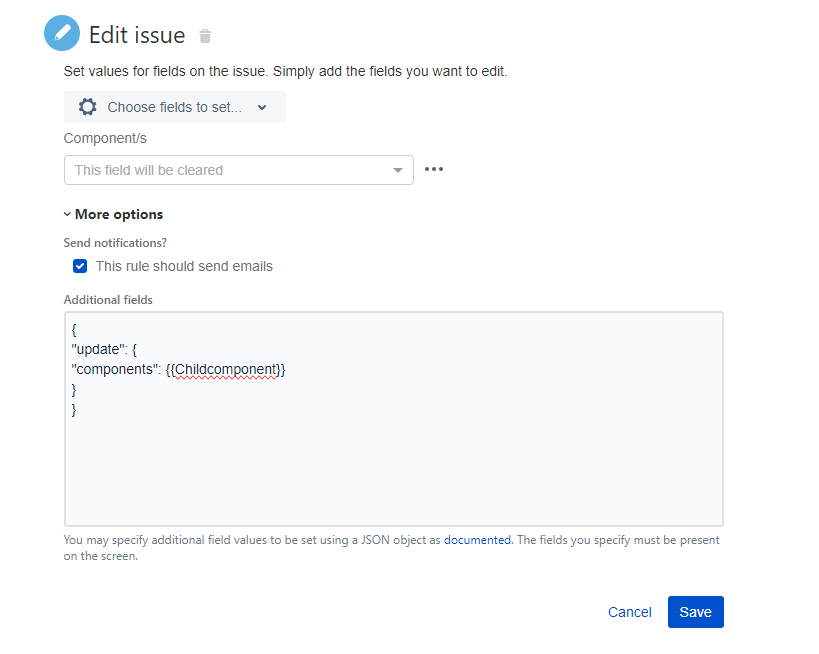

Then you go to -> edit issue and go down to additional fields and put in below JSON to only add and not replace.
"update": {
"components": {{Childcomponent }}
mattics phi
January 26, 2024
Sorry for my tardiness, I was only able to get to this now.  And of course, this is perfect, thank you @Kalyan Sattaluri !  Works flawlessly :)
