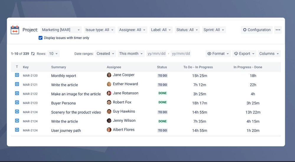

Hello @Artur Cybruch
As an alternative , I guess you can try Time Between Statuses or Time in Status for Jira Cloud developed by my team SaaSJet.
Time between Statuses is the add-on, which measures connections in the workflow, through a transition time in specific issues. You can count Cycle and Lead Time by setting start/stop and pause statuses in the configuration manager. To detail the calculation conditions you should select the first/last transition to/from status.
You can customize your Cycle and Lead Time reports by adjusting the app interface fields such as: Type of Project Date range Time Format Multi Calendar (to configure non-working hours and different calendars.) This add-on also allows you to export data in XLSX or CSV formats.
Time in Status for Jira Cloud will be an option for you too if you are already switching to cloud version. you get Cycle and Lead time by setting Status Groups. You can configure it from your account at the Column Manager with the drop-down list of the statuses. A custom report can be placed on the main Jira dashboard with the special Gadget tool, and you can export data in XLSX or CSV formats.
Cycle Time.gifAdd-ons have a 30-day free trial version and free up to 10 users.
Please, let me know if you have any questions
Hope it helps 😌
Valeriia

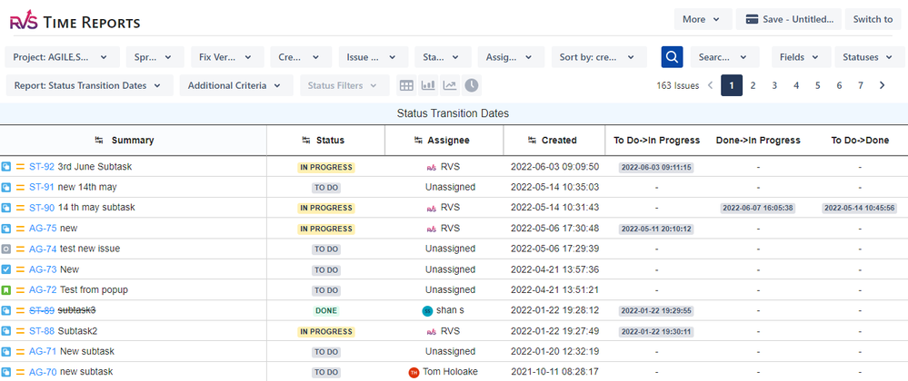

Rahul_RVS
Atlassian Partner
May 24, 2023
Hi @Artur Cybruch
Welcome to the community !!
Not sure if this data is available out of the box. However if you would be interested in app, you can try out
Agile Tools : Epic Tree, Links Tree, Time in Status & Worklogs
The add-on provides the status transitions for the entire lifecycle of the issue, as in the screen grab below
There are 20+ reports in the app which help to meet a wide range of use cases plus many other use cases are covered like Hierarchy reports, worklogs reports etc.
Do try it out.
Disclaimer : I work for RVS, the vendor for this app
