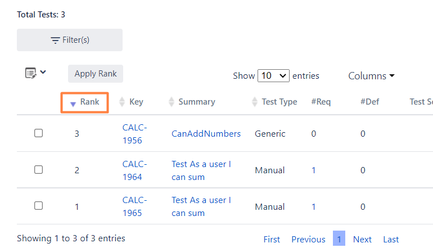

It is currently impossible to obtain the Test cases order by Rank either on the REST API or with JQL. In Xray Server/DC, you can, however order the Test cases by Rank inside the Test Execution like this:
Thank you.
Kind regards,
Rogerio Paiva [Xray Support Team]
