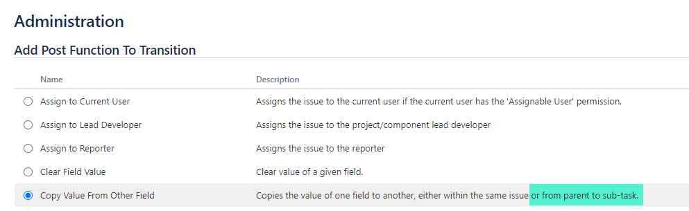

I did look at Automation - allows copy from Parent to Sub-Task, but not from Sub-Task to Parent, unless I'm missing something?

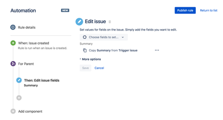

Jack Brickey
November 9, 2020
should be possible. Maybe the following would help? you will have to adjust for your specific situation w/ appropriate sub-task conditions.
Holly C_ Langley
November 10, 2020
I will try this...am being sidetracked by other duties.  Thank you!
Holly C_ Langley
November 16, 2020
Still need to do some testing, but it seems to have worked.  Thanks!
