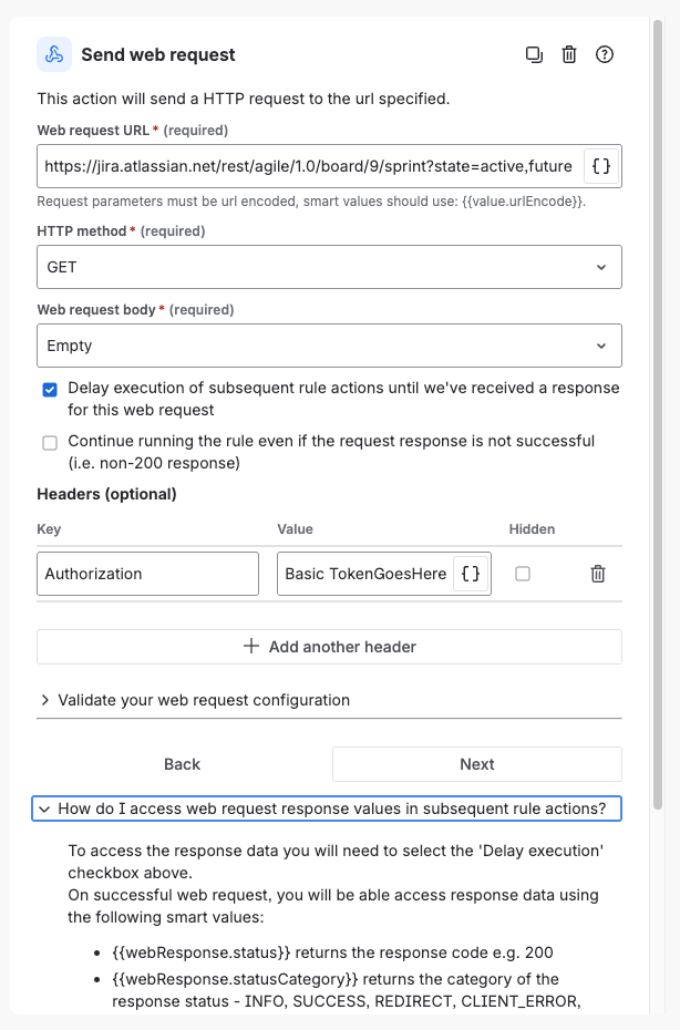

@Hari Shankar Gadamsetty
In the Web Request URL:
- replace jira.atlassian.net with the URL for your Jira instance
- replace 9 with the ID number for your Scrum board. That shows in the browser URL field when you are viewing the board.
In the Headers:
- replace TokenGoesHere with you encrypted API token. Refer to the article I referenced before to get information about creating and encrypting a token.
https://community.atlassian.com/forums/Jira-articles/Automation-for-Jira-Send-web-request-using-Jira-REST-API/ba-p/1443828
Notice the information at the bottom of the action configuration.
If you want to check that the API call succeeded, add a Condition component after it to check the {{webResponse.status}} value.
To access the sprint data you will need to use the smart value {{webResponse.body}}
The Accepted Answer on the following post describes how to iterate over the results in the webResponse.body and take actions based on each one.
https://community.atlassian.com/forums/Jira-Service-Management/Automation-loop-through-WebResponse-results/qaq-p/2140920
