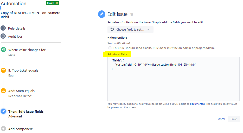

giulia.perelli
May 29, 2020
JIRA CLOUD - no plugin
Has anyone tried to use a JIRA automation rule ?
I defined a numeric custom field 'Numero Ricicli' with ID =10119; default value is zero.
I'm testing the attached rule:
  • WHEN check if the 'status' field changes value for transition issue or edit issue
  • IF the issue type is Bug
  • AND the Status equals 'Reopened Defect' value
  • THEN: I choose the Edit Issue Action to increment the numeric custom value of 1 (so, if current value is 0, it should be set to 1).
    My numeric custom field is not displayed in the drop down list, so JIRA forces me to wirte a JSON code on the 'Additional Fields' box.
I use the attribute 'field', because 'update' is for multiple values field.
Documentation on Advanced field editing (JSON) https://confluence.atlassian.com/jirasoftwarecloud/advanced-field-editing-json-993927646.html
Both math operators gives this error during rule execution.
I tried:
the sum operator {{#=}}{{issue.customfield_10119}}+1{{/}}
(https://support.atlassian.com/jira-software-cloud/docs/smart-values-math-expressions/)
and then
the increment operator {{#increment}}{{issue.customfield_10119.value}}{{/}}(https://support.atlassian.com/jira-software-cloud/docs/use-smart-values-to-insert-numerical-values/)
Can anyone help me to solve the "Error while parsing additional fields. Not valid JSON. "?
Thanks a lot!!!

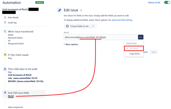

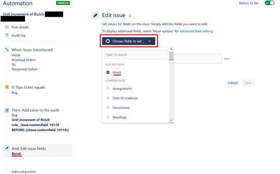

giulia.perelli
September 17, 2020
[SOLVED WITH NATIVE FEATURE]
Hi community!
When my custom field became available in the drop-down list "Choose field to set..." in the "Edit Issue" action, I set the unit increment for the selected custom field and I left empty the "Additional fields" box.
I suggest to add an action to log the previous value; it's really helpfull in troubleshooting.
This automation rule works and the Customer appreciates a lot!
I love the Automation Rules for JIRA: no more human error on update the data and no more effort on repetitive tasks!
Jira Administrator can easly find  when the rule was triggered and what was the result. The audit log is a powerful tool to monitor any changes in the rule configuration and to troubleshoot any incongruent data by the Audit Log.
Hope it helps!
Bye,
Giulia
Note:
the trigger has changed from "Field value changed" to "Issue Transitioned" because there are more than one transition incoming in the Reopened status. I switch to "Issue Transitioned" for other reasons, nothing to do with the logic of reopening an issue.
Like # people like this

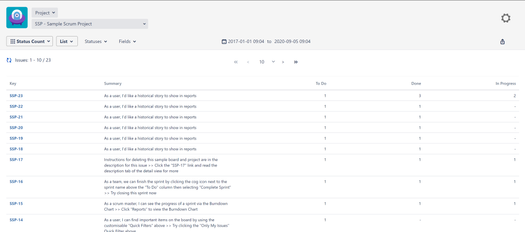

Emre Toptancı _OBSS_
Atlassian Partner
September 16, 2020
Hello All,
This is an old question but I see that it has been seeing a lot of action lately.
For anyone here who are interested in a ready-to-go solution, our team at OBSS created Timepiece - Time in Status for Jira app for this exact need. It is available for Jira Cloud, Server and Data Center.
Using Time in Status you can also see the number of times each status or transition was used (very useful for inspecting things like reopen counts).
You can report how much time each issue spent on each status, each assignee or even each user group. (useful for identifying bottlenecks in your process). You can consolidate multiple statuses into a report column (useful for calculating metrics like lead/cycle times). You can also list the status entry/exit dates.
The app calculates its reports using already existing Jira issue histories so when you install the app, you don't need to add anything to your issue workflows and you can get reports on your past issues as well.
Using Time in Status by OBSS, you can produce reports based on the default 24/7 calendar or define your own business calendars with custom workdays and working hours.
All data can be exported as XLS, XLSX, CSV and can be accessed via REST API.
