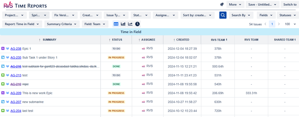

For a readily available solution, to calculate the age of an issue, you might be interested in a mktplace app,
Time in Status Reports
The "Time in Status" report with Status grouping feature, and the "Time between Statuses" report can help to meet your use case of calculating the issue age.
The app also has "Time in Field" report which can help the total time your issues spend in a particular field value.
Also the app has 20+ reports to meet a variety of use cases.
More details here.
Disclaimer : I am part of the app team for this add-on

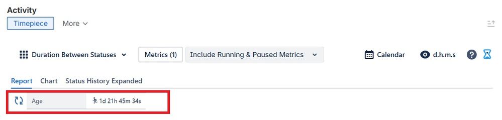

Timepiece - Time in Status for Jira has a solution that calculates "Issue Age" instantly without needing a custom field.

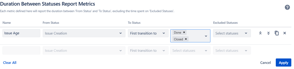

You can use its Duration Between Statuses report for this.
It allows you to define a metric to measure the total time from the start of your workflow (Issue Creation) to the end (Done or Closed).
The best part is that you don't need a custom field to see this on the ticket. Timepiece adds a dedicated tab to your Issue View screen. You can open any issue and instantly see its "Age" (and other duration metrics) calculated precisely from your history.
Plus, it works retroactively for all your past issues from day one.
You can check Timepiece on the Atlassian Marketplace. Hope this helps you track your issue age easily.

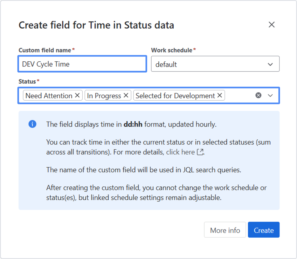

Yes – if you’re OK with using a Marketplace app, you can do this with Time in Status by SaaSJet (I’m part of the team that builds it).
!!! If you want to migrate to the Cloud, this solution may be useful.
Our app has Time in Status custom fields that let you show how long an issue has been open in a field like Age and display it right on the issue view or board card.
How it works
You can create a custom field that sums up the time an issue spends in selected statuses. For “Age”, you’d typically group all statuses except the final one (e.g. Done, Resolved), so you get the time from creation until completion.
Setup steps (company-managed board)
  1. Open the Time in Status Agile Board
    On your project board, use the dropdown in the top-right and select Time in Status Agile Board.
  2. Create a custom field (e.g. “Age”)
    • In the modal, enter a name like Age.
    • Select the working calendar you want to use (24/7 or only working hours).image-20251121-143300.png
  3. Choose what to measure
    • Select Group statuses.
    • Add all statuses in your workflow except the last one (Done, Resolved, etc.).
      This will give you the total time an issue spends “open” before it reaches the final state.
  4. Add the custom field to your screens
    • Go to Jira settings → Work items → Custom fields.
    • Find your new field, select Associate to screen, then add it to the relevant screens.
  5. Show it on the board
    • Open Board settings → Card layout.
    • Add your custom field so the Age value appears on the cards.image-20250905-111116.png
What you get
  • The field updates automatically (roughly every hour, and shortly after a status change or when the issue is opened).
  • Values are shown in dd:hh (days:hours).
  • You can also use this custom field in JQL to filter or sort issues by their age.
Note: Creating Time in Status custom fields requires Jira admin permissions and is available for company-managed boards.
