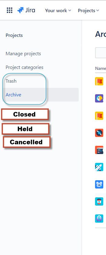

Currently, there are only two options for projects that are not active, "Trash" or "Archive" .  We would like to identify/categorize projects that would fall into these categories:
"Held"
"Cancelled"
"Not Started"
"Closed"
Is there a way to do this at the project level?

Nic Brough -Adaptavist-
June 29, 2022
No, that's not a status or field, it's a functional thing.   Trashed projects will be deleted eventually, and archived ones are not indexed.  It's not a project status.
Kristine Gemici
June 29, 2022
Thank you Nic! Is there any way to add an "index" to archived projects??
June 29, 2022
The point of archiving is to drop them out of the index - they're not supposed to be actively used!
There is something you could do though - Jira has a simple implementation of a "project category" (it's actually in the screenshot you gave in the question).  It's a single project field, so you can't do things like "project is green AND blue at the same time", but you can set up whatever categories you want and group projects into them.
It can also be used in searches - "category = green" will return all issues in all projects that are categorised as "green"
