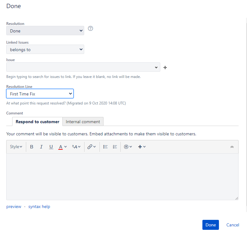

@Jack Brickey @Curt Holley any ideas as to how I would add it here?
What screen is this? Basically you need to add the Component field to the screen. Project settings > Issues > screens click the pencil icon which takes you to the screen scheme. In the table click the name of the screen which takes you to the list of fields on the screen where you can add Components.
That was my thought. Assuming so then edit the screen used in the transition to done and add component.

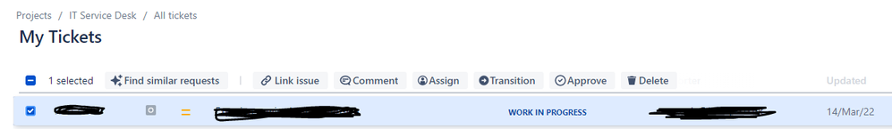

My question is based around this example:
In this imagine, I have selected a ticket but I have no option to be able to add a component to the ticket without going into the ticket itself. I was wondering if there is a way to add a component to this ticket from where I am
The only way would be via automation. But to do that you need to understand the condition/s under which a component would (or wouldn't) need to be added, as well as the trigger that would get the automation to run.
But as @Jack Brickey says, we really need to better understand not only the Where or How, but also the Why. As wanting to edit an issue without touching it is quite the trick (thus automation as my suggestion).
