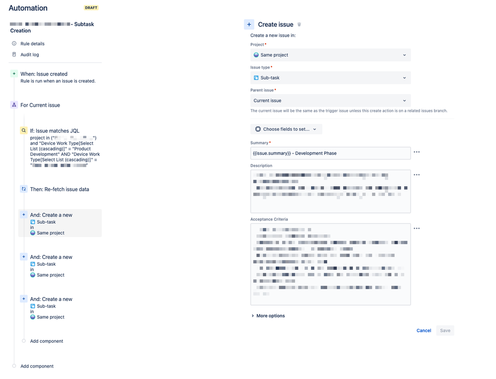

Dave Armstrong
January 13, 2023
Thanks @Bill Sheboy that got it working. I assume only the original poster can "accept" an answer, but I truly appreciate your help.
I already had a branch under the "When: Issue created", so I just had to add the "Re-fetch issue date" action and then I updated my "Create a new Sub-task" to include {{issue.summary}} in the Summary, worked like a charm.
My rule now looks like this:
  • When: Issue created
  • (Branch rule) For Current issue
    • (New Condition) If: Issue matches JQL
    • (Action) Then: Re-fetch issue data
    • (Action) And: Create a new
      • Project = Same project
      • Issue type = Sub-task
      • Parent issue = Current issue
      • Summary = {{issue.summary}} - Development Phase
Like Bill Sheboy likes this
Bill Sheboy
January 13, 2023
Hi!  I recommend moving the Re-fetch up to immediately after the trigger.  Otherwise there is a chance that JQL condition could fail to match when the data is not ready yet.
