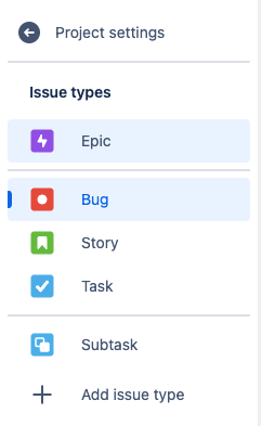

The issue hierarchy in a Team Managed project is
Epic
|-- standard level issues (i.e. Task, Story)
|-- subtask
Example from Project Settings / Issue Types:
Can you show the comparable image from your project, please? Team Managed projects don't support adding another level above Epic. I'm trying to understand how you have added Initiative to the hierarchy.

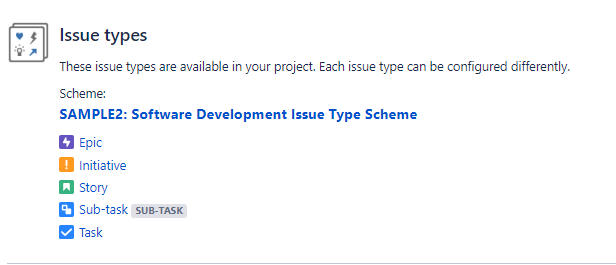

The image you provided is for an Issue Type Scheme. Issue Type Schemes don't apply to Team Managed projects. They apply only to Company Managed projects.

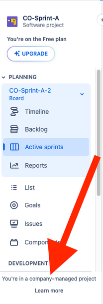

Can you verify the type of the project that you are working with by looking it up on the View All Projects page under the Projects menu and telling us what it says in the Type column? You should also be able to find the information at the bottom of the navigation panel on the left when viewing the project data. Team Managed projects are available only on Jira Cloud.

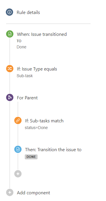

With Automation Rules you could create a rule triggered by the change of status of the child issue. The rule construct the rule to look at the the statuses of the child issues under the same parent, and then tell it how to set the parent status based on those values.
Because you are on Jira Data Center you would need a rule to do this when the child is a subtask, another rule for when the childis at the story level, and another rule for when the child is an Epic.
An example would be something like this:
The rule for a child issue transitioning to To Do would be the same except for changing the Status value in the Trigger, Condition, and Transition.
The rule for In Progress would be slightly different. Since the child issue is transitioning to In Progress and you know you want the parent to be In Progress also if any child is In Progress, then you would not need the condition within the For branch.
I suspect the rule for updating the parent Initiative would be different because Automation Rules in Jira DC don't have a native For branch for parents in the extended issue type hierarchy. I don't have a DC system with an extended issue hierarchy where I could test out the solution. I'm not sure if it could use the For Related Issues / Linked Issues option, or if another method would need to be used.

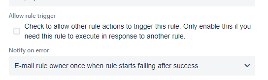

Each rule would need this box checked on the rule details page.
