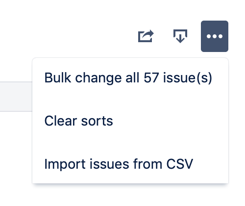

  1. Choose the Jira icon ( or ) > Filters.
  2. Select Search issues.
  3. Click more (•••) at the extreme top-right of the page and choose Bulk Change all n issues.
  4. Select the issues you'd like to perform the bulk operation on, and click Next.
  3. Click more (•••) at the extreme top-right of the page and choose Bulk Change all <n> issues.
