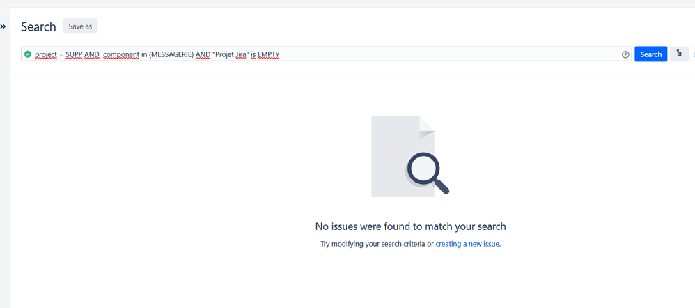

Hello I'm trying to see issues with a certain component with a custom field empty
I preform this filter "project = SUPP AND component in (MESSAGERIE) AND "Projet Jira" is EMPTY" but it doesn't show anything while there are many tickets in this case
Is there a way to have the good result? Or is my filter wrong?
Thank y'all for the concern

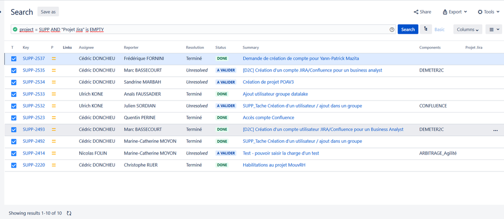

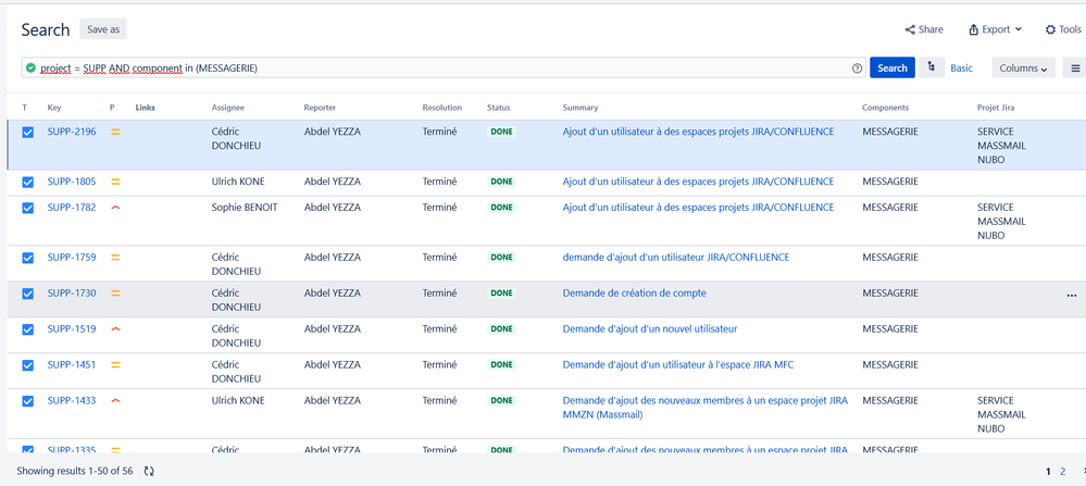

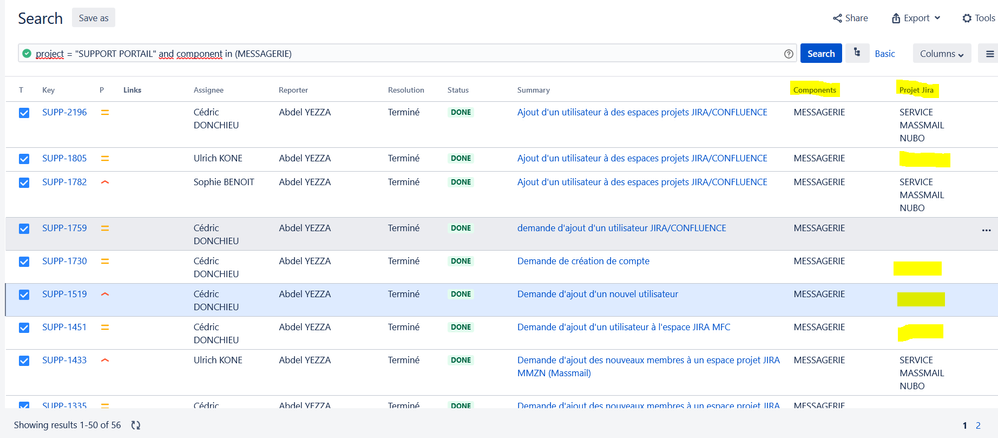

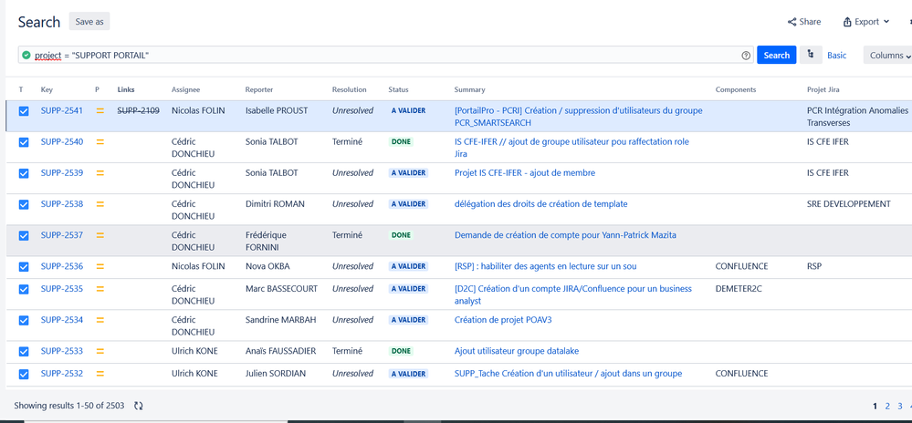

Ulrich Kone
June 22, 2023
Hello @Deepak Jain
Thanks for your answer. Il attached the screen needed.
The Custom Field is only set for the project SUPP and the component value too.
ATL COMMU - Component Mess and CustomFld Empty.PNGATL COMMU - Component Mess.PNGATL COMMU - SUPP and Component.PNGATL COMMU - SUPP and CustomFld empty.PNGATL COMMU - SUPP.PNG

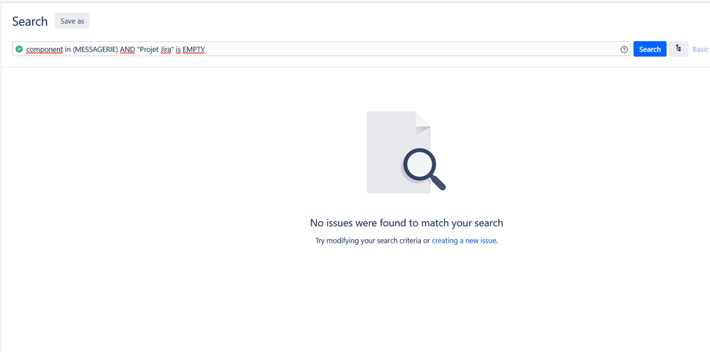

Valerie Knapp
June 22, 2023
Hi @Ulrich Kone , thanks for your question. Have you verified that there are issues that match this criteria? The green tick is indicating that the query is written correctly so I would check the issues first.
Ulrich Kone
June 22, 2023
Hello @Valerie Knapp, thanks for you answer. There are several issues that meet this criterion mentioned in the jql.
