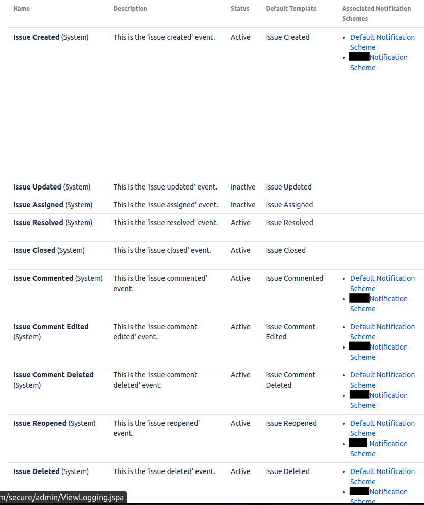

Michal Glod November 18, 2021
These are the notification scheme and workflow events, the notification scheme you see in the above screenshot is the one beneath default notification scheme in the screenshot directly above, as you can probably tell it is named after a costumer so I had to blank it out.

Tom Lister
November 26, 2021
Hi @Michal Glod
Been busy on my day job.
There is nothing about the configs that looks like it would cause an issue.
check
  • Check if the My Changes option in the user's profile is Notify Me. The default value for this property for all users can also be set under Administration > User Defaults
  • Check the project permissions under the project's permission scheme. Users must have Browse Project permission for the project to which the issue belongs. If you're using Issue Security Levels, ensure they are members of any Issue security levels that have been applied to the issue.
  • Inspect the Mail Queue under Administration > Mail Queue and see if notifications are being queued. You can adjust the Mail Queue Service interval to a longer period for troubleshooting purposes. Inspect the Error Queue tab for any errors.
ref https://community.atlassian.com/t5/Jira-questions/Single-user-does-not-receive-notifications/qaq-p/1005051
You could also go to logging and profiling and turn on the outgoing email logging then check for any errors or references to the missing users.
Check the email for the user is correct. I can be different to the username.
Other than that , I'm not sure what else to investigate
