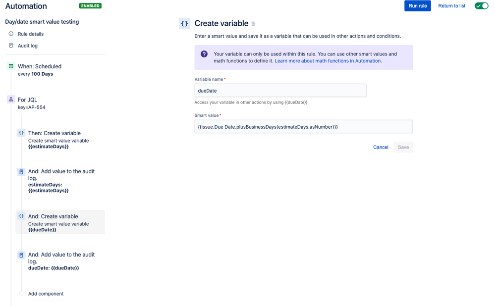

Hi @Diogo Teles, what you're trying to do is possible. There are just a few additional things to recognize about smart values before it'll work.
Here is the solution that you're looking for, I'll explain it below.
Two things:
1. Once you're insight of the handlebar syntax `{{`, you don't need to use it again to reference variables.
2. The create variable action stores the variable as a string, so one needs to use the asNumber function to coerce it into a type appropriate for use inside plugBusinessDays.
Hope that helps. :)
Thank you so much! I was so close, during one of my tries, I did use asnumber but to create another variable. Which, from what you explained here, was pointless as it converts it to string again. Then tried to use that variable for the plusdays(). I did call it without {{}} at one point but it just deleted the date. Now I see that was because it had a string in the input.
I really appreciate the example and the explanation, thanks.
