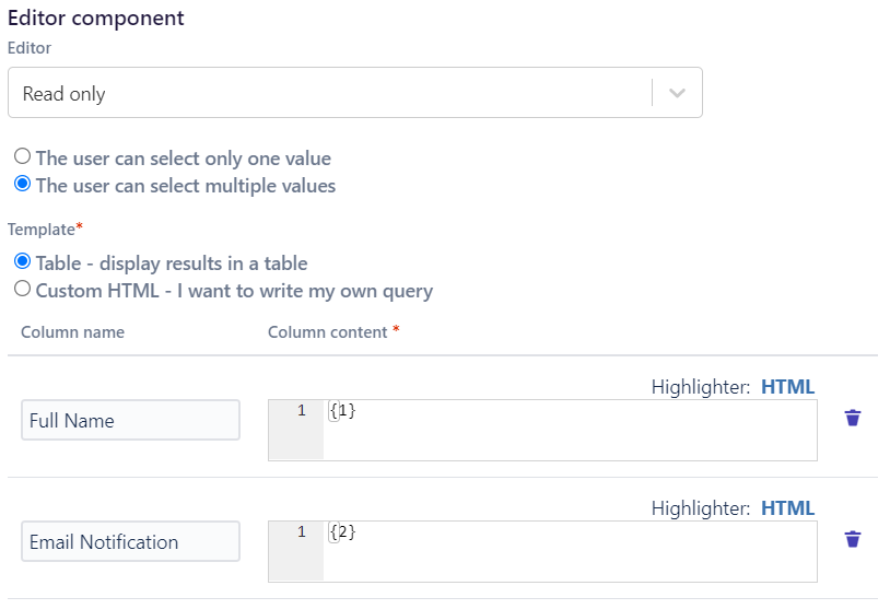

    • Then configure the Editor and the Template as below:

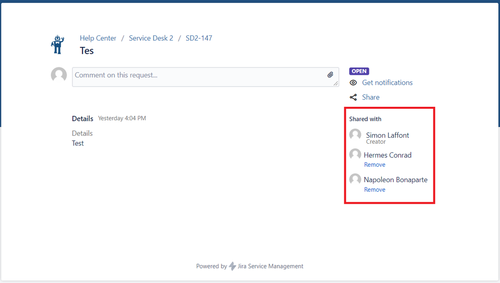

Now, let's take the example of the following request:

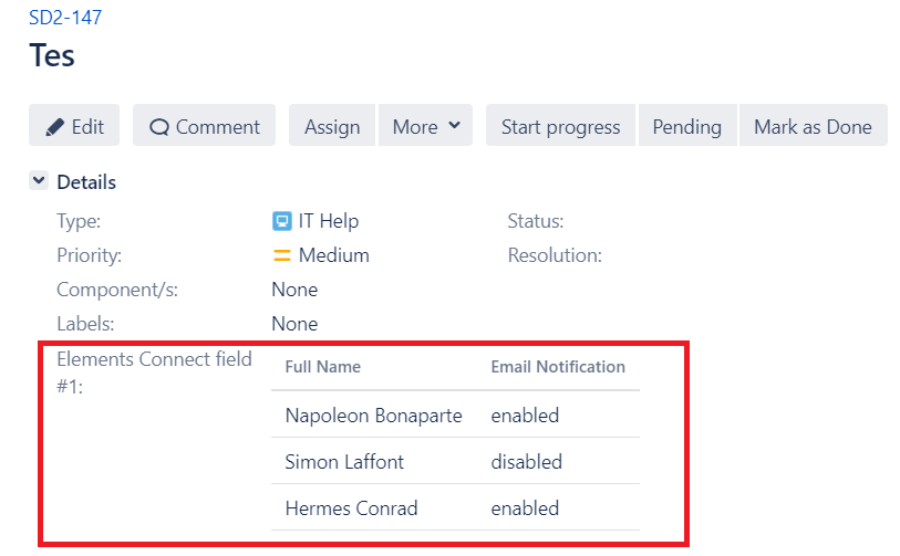

This is the result we get in the Agent view:
Please note that when you add this Connect field to your project, it will not be updated automatically in existing issues. You will have to update this field in each issue, either manually or with a script.
