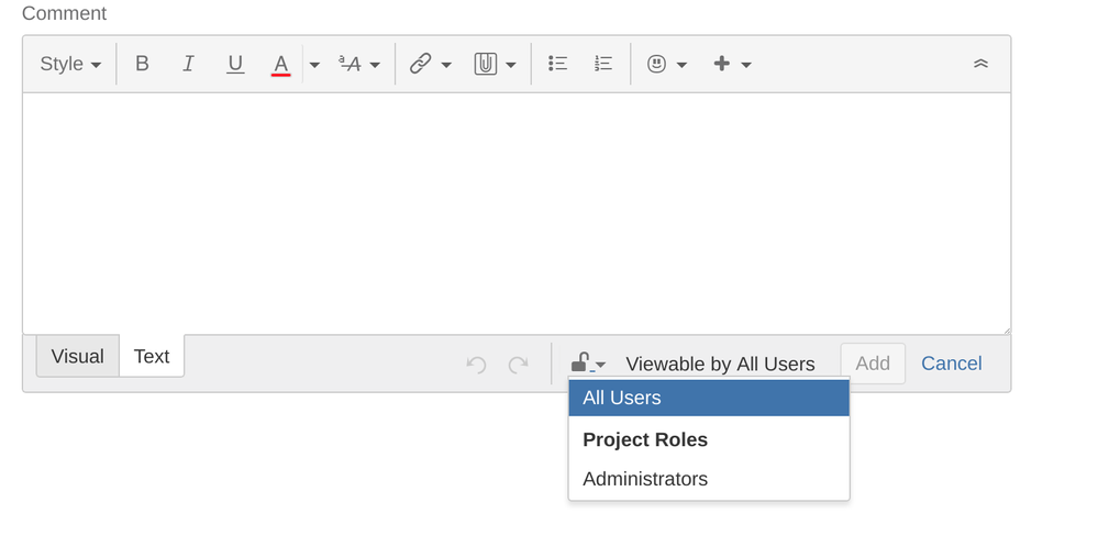

There is also another option that you can use: comment security. But this means that your reporter will also not be able to see all the comments made with this security option.
Selection_066.pngThese are the ones that come to my mind but maybe other users can offer other solutions.
