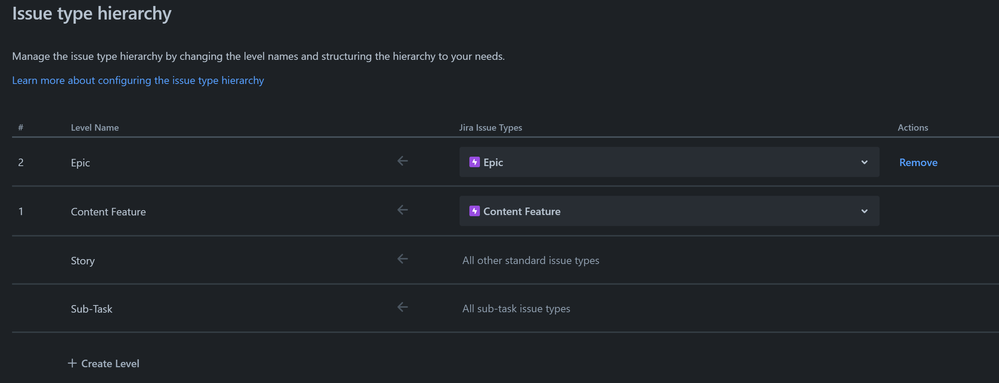

Thanks for sending this over - I have followed your step provided above and seem to have made some progress, however still not quite how we'd like the configuration.
Here is the new hierarchy, which I assume is correct?

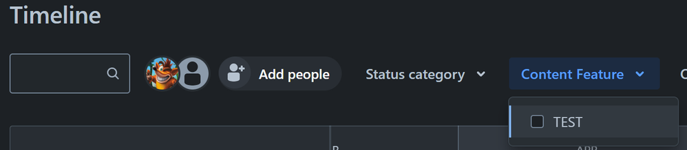

On the project side however, we're still seeing some of the same issues - for example now the "Epic" section on the project has become content feature (which would be expected)

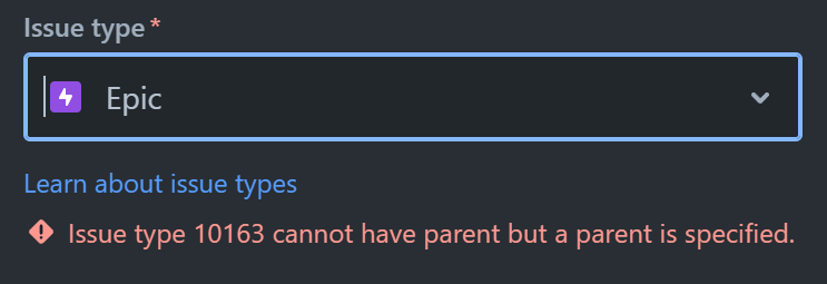

Specifically in the timeline view, when creating an issue it wants to create it as a content feature, and when trying to create an epic we get the following message;

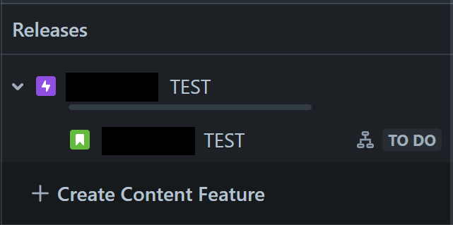

Also in the timeline view it nests it as follows and disregards the "Epic" level above.
If I try to use another view such as a list view, it appears as we would like.
Is it possible to get it to view like this in the timeline view and have "Epic" as the primary issue and show anything under this?

Your first screenshot appears to be set up correctly, based on my instructions.
The Timeline on a Board only works with the standard hierarchy - i.e Epic > Story > Sub-task. You cannot display the additional levels within this feature
The wording for "Epic" is then flexible - so changing it to Content Feature means that is the Issue Type which will now work from within the Timeline.
If you want a view with the additional layers, you'll need to use Plans for this. These are the "advanced" planning features, available through Plans on the top navigation bar.

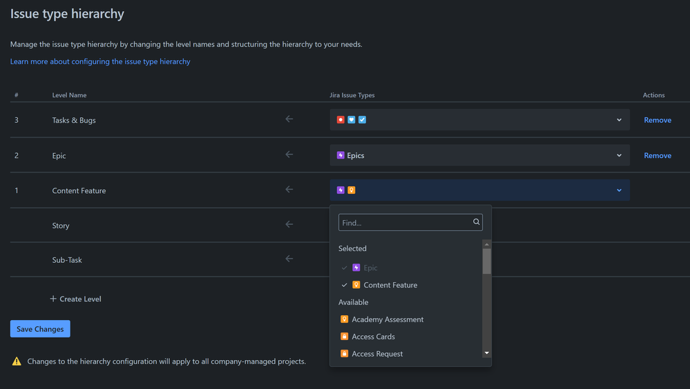

Here is a screenshot of our Hierarchy field.
Thanks!
Lewis Rafferty
April 13, 2024
Please ignore the tasks & bugs section, this needs moving from its current position.

Yeah, that's not correct. You need to remove the Content Feature issue type from Level 1
And remove the Level 2 and Level 3
Then start over with my steps above. You should not have two Issue Types at Level 1.
