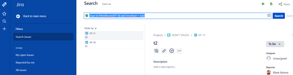

I could only get for one issue for the links it has, you can use the same with the issuetype selected as bug.
issue in linkedIssues(DT-9) and issuetype = task.

I was looking for the defect count and associated to each story. Since this is for a report I won't be able to use functions that give result only for a particular story.
