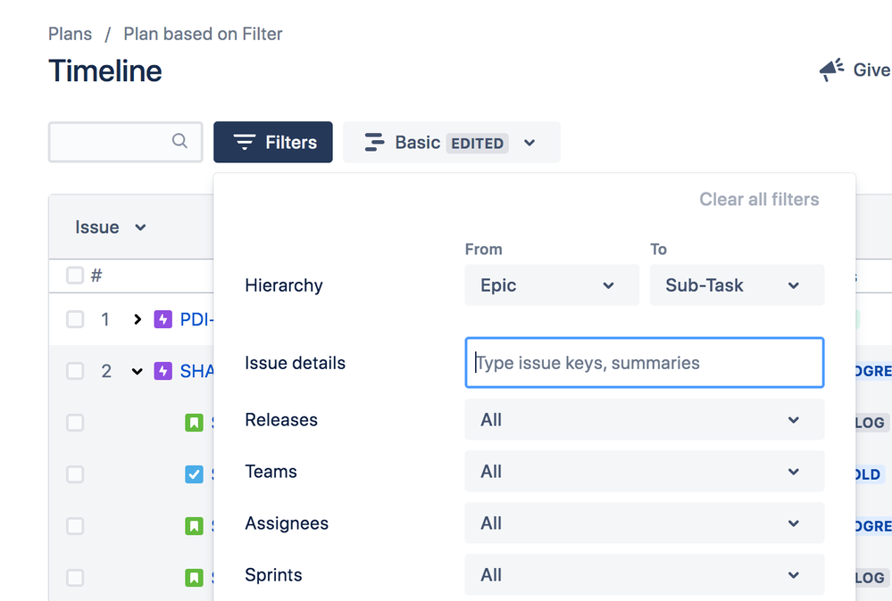

I created a test plan based on a filter and I can see Epics. I had to go into Filters and make sure it was showing Epics, see image.

Is the filter made with one or two projects? Because the problem I have is when the filter has more than one project. Thanks!
Sandra Axelsdottir
June 10, 2023
Yes, in the example I shared there are a few projects, you can see the beginning of two different issue keys in the image I shared PDI and SHA.
I’m not sure what your problem could be. Have you checked all the settings, like issue source and exclusion rules?
Regards
Sandra
