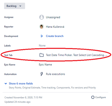

I don't think it is possible to do it, only limited types of fields are available in cloud version of SR so far and there are not suitable for your use case. There's HTML type in server version - but still even if this type would be available in cloud, I won't recommend you to use it. I can see two main reasons:
  1. your field will be calculated - but there is no reason to calculate something, you just need different view on issue's data
  2. you will need to provide all the table HTML formatting, which could change every time Jira updates the view of issues

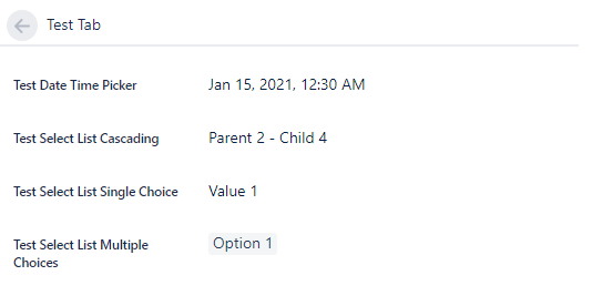

Have you considered to separate these fields into the another tab?
Your tab will be visible in the issue view and when you click on it, you will get the detail like this:
