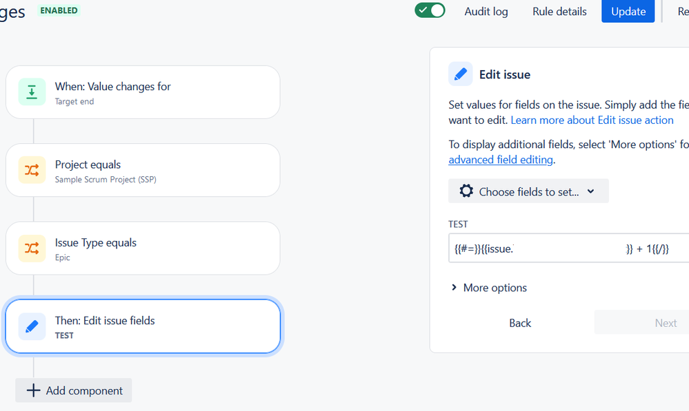

Daniel McCollum
February 14, 2024
Jira automation looks like this...NOTE: field name blanked.
Also, unable to set read-only text field to value, which may be part of issue for count not kicking off (IMO)...
Daniel McCollum
February 14, 2024
@Kalyan Sattaluriapprecite your reply and described steps.
Screenshots were placed above, one of jira rule (pretty basic) and one of an attempt to edit read-only custom field in question.
I copied url provided, and executed by hitting enter using the updated api version 3 in addition to api 2 (from your original url posted):
Both resulted in the same data.
I was able to search and find my custom field from view on JSON tab in two places - one was custom field id and other down below on page result showed null value.
