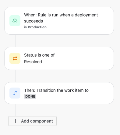

Giulio Troccoli-Allard
August 7, 2025
Although the above worked, it also failed. I don't really understand why, but the tickets where correctly transitioned and I also had a rule failure (for the same tickets).
What I did to fix it was to only transition tickets that were in the Resolved statusScreenshot 2025-08-07 at 11.10.13.png

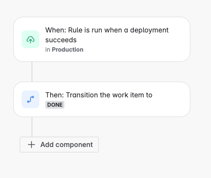

August 5, 2025
I fell a bit stupid now, because I think I've got it (although I haven't tested it yet).Screenshot 2025-08-05 at 10.40.34.png
I don't know why I couldn't find that trigger before
August 7, 2025
