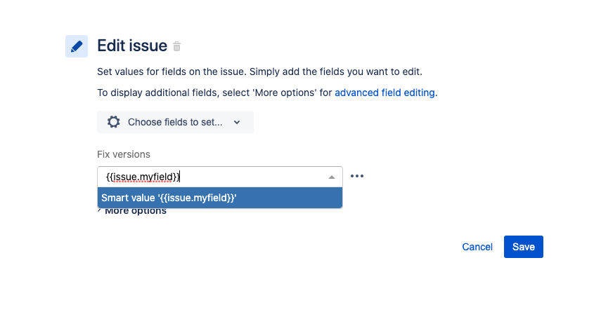

You can actually type in smart fields with most edit fields, it won't be recognised as one until you put in the {{version}} though, see attached screenshot. You should also see other field options such as copying from issue etc.

Woah, I wasn't aware that you could do this. To me, it wasn't intuitive as the Fix Version field dropdown box made it seem like you had to select one of the options. Thank you for the feedback, your suggestion worked!

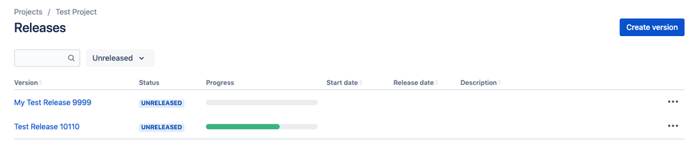

I thought this would be the case, however, when I was testing in my sandbox project I found that if there were multiple unreleased versions in the Releases table "Next unreleased version" would always select the version at the most-bottom row.
In the image below, a newly created ticket would always get tagged with the "Test Release 10110" version instead of "My Test Release 9999".
Screen Shot 2020-12-18 at 7.11.42 AM.pngNonetheless, thank you very much for replying and ultimately solving my problem!
