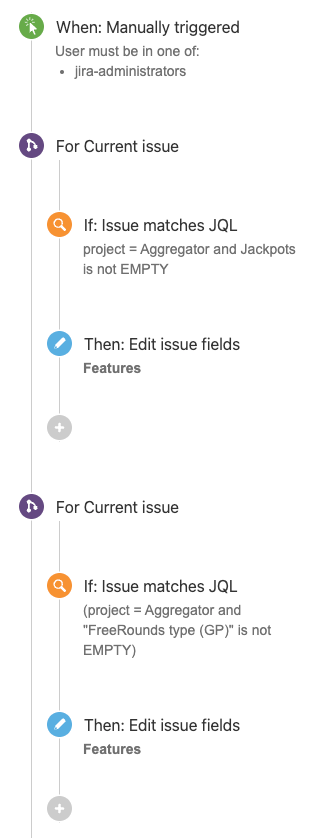

Hey, yes I can, it is simple like this:

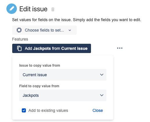

The edit issue action looks like this:
Maybe the issue is that I am copying from a checkbox field into a Select List (multiple choices)?
John Funk
July 20, 2023
That's probably it with the different field types.
