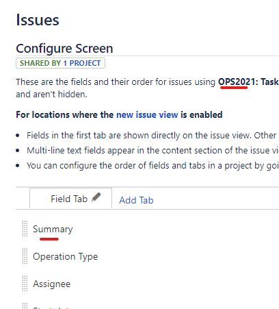

Hana Kučerová
August 8, 2021
Hi @ARCode ,
according to the error message I would check, if Summary field is on Create issue screen in your project, where you are trying to create the issue.
See more here about screens.
ARCode
August 9, 2021
Hi @Hana Kučerová
Thanks for the answer, I've check over and over again on my screens settings, the summary field is in there .. You can see my screen capture.
