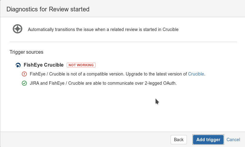

I am trying to add Issue trigger "Create review" but I have a message that I use too old version of Crucible.
I have the latest version of JIRA and Crucible installed.
Does anyone know about incompatibilities between JIRA 7.5 and Crucible 4.5?

Michał Piotrowski
September 21, 2017
I am not sure if I caught correct log snippets, but those log entries appeared  when I tried to add "Create review" trigger.
I am also attaching screenshot of the error message.
